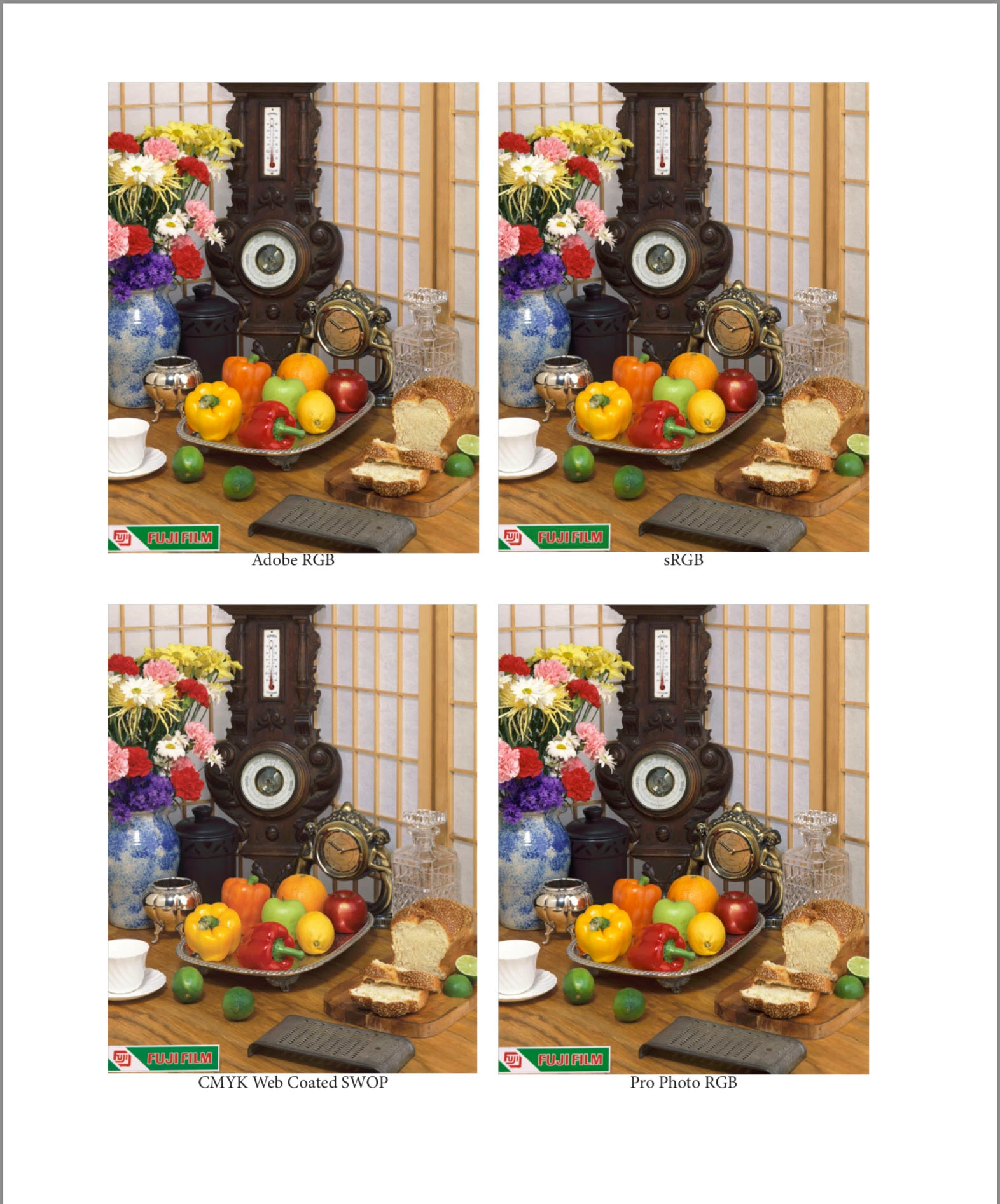

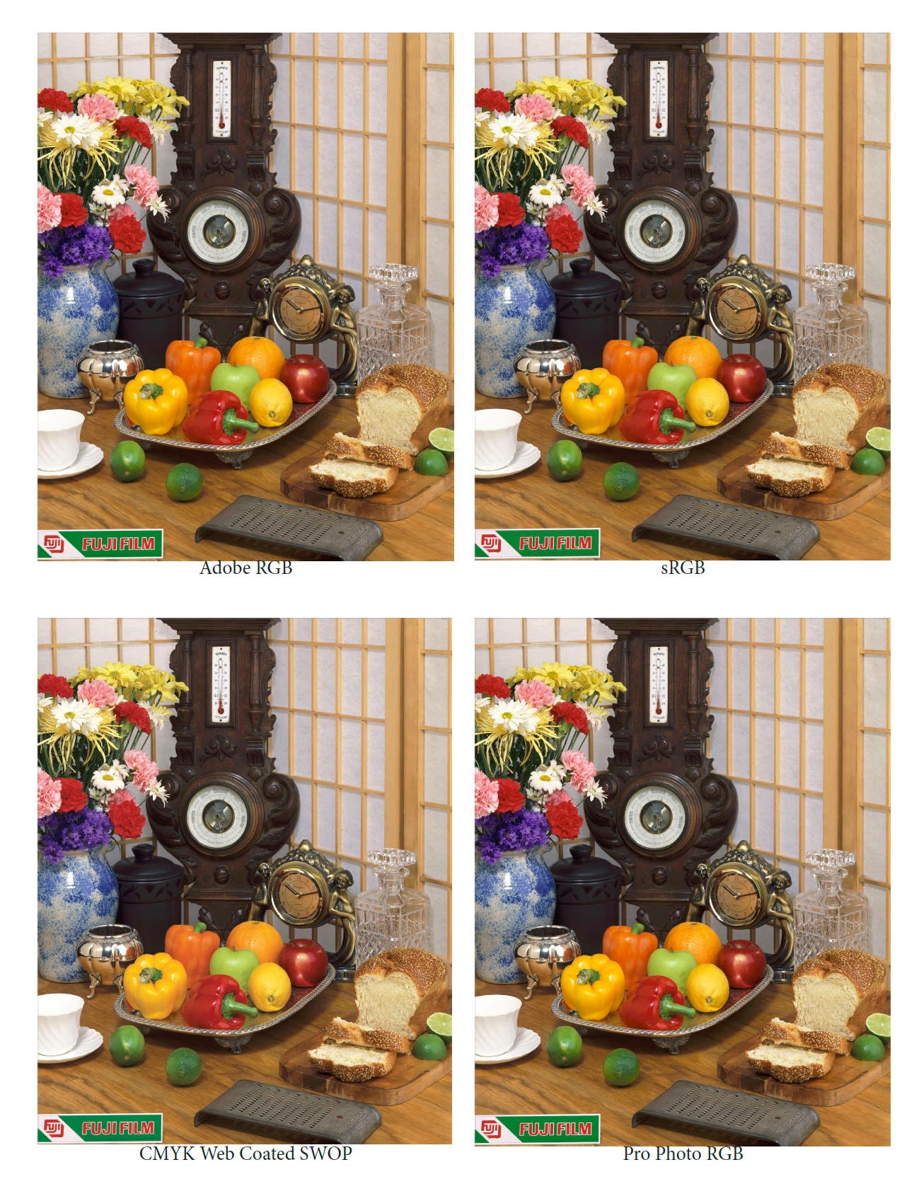

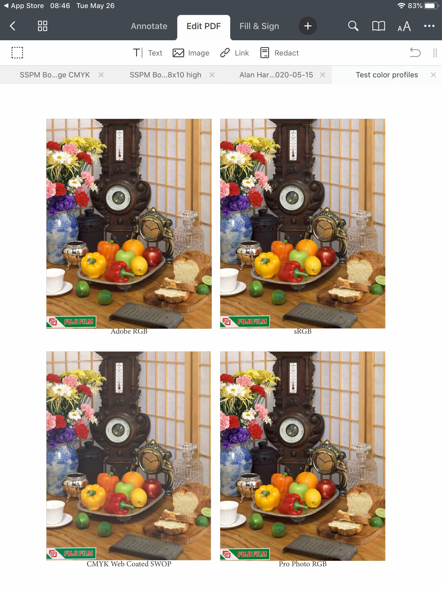

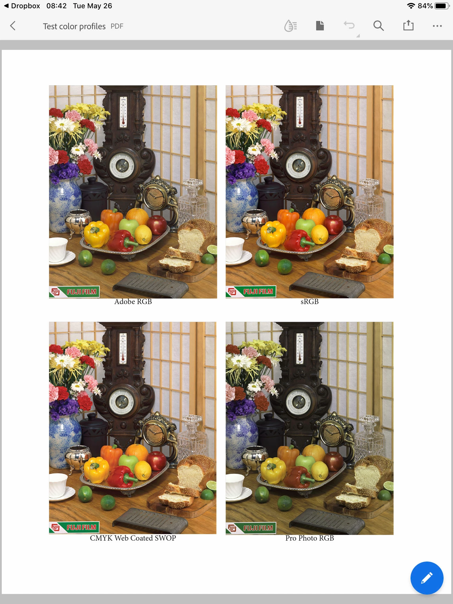

I just created a test case. I took a public domain large-gamut image and I used Photoshop to save it in four profiles (color spaces): ProPhoto RGB, Adobe RGB, sRGB, and U.S. Web Coated (SWOP). The first three of course are in RGB space, the last is in CMYK. And these color spaces are in order from wider to narrower gamuts. This means that the same numbers (in RGB) specify less saturated colors in ProPhoto RGB than they do in sRGB.
It appears that Adobe Acrobat for iOS is ignoring the embedded profiles, and therefore is rendering the colors incorrectly.
First the screen shots.
1) Adobe Acrobat on iPad (v. 20.05.00 (20200512.193622))
2) PDF Expert on iPad (probably uses Apple code to render pdfs)
 3) Adobe Acrobat Reader for MacOS (no apparent problem)
4) Skim for MacOS (uses Apple code to render pdfs)
I can give you the pdf that I used to obtain these results, and, in fact, the entire InDesign project so you can follow through how this was created, but I can't seem to do it directly into this discussion group. Let me know how you want me to proceed.
