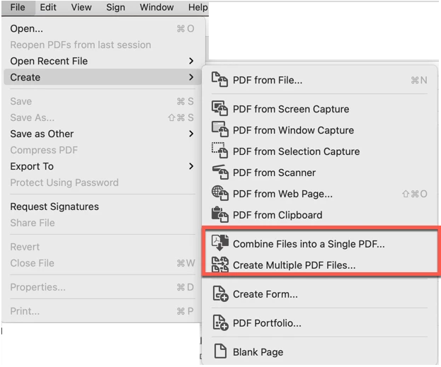

Now, I state that you can drag them onto the Acrobat icon but you can get the same result if you select either of these options here:
Now, one last hint: if you make sure the name of your documents are in proper order before you do the PDF-ing, you will not have to worry about their order in the final document. That is, if the names of your files are Joe.tif, Sam.tif, Mary.tif, there's no telling how they will land in your new single PDF. But if you number them, either 01-Sam.tif, 02-Joe.tif, etc. Than their order is secured. Oh, one more on this issue: if you scan into a folder, typically the 2nd item will be auto-numbered. That is noname.tif, noname-2.tif, noname-3.tif, etc. If you remember, it's important to fix the first one and call it noname-1.tif. Otherwise that first one will be at the end of your combined document.

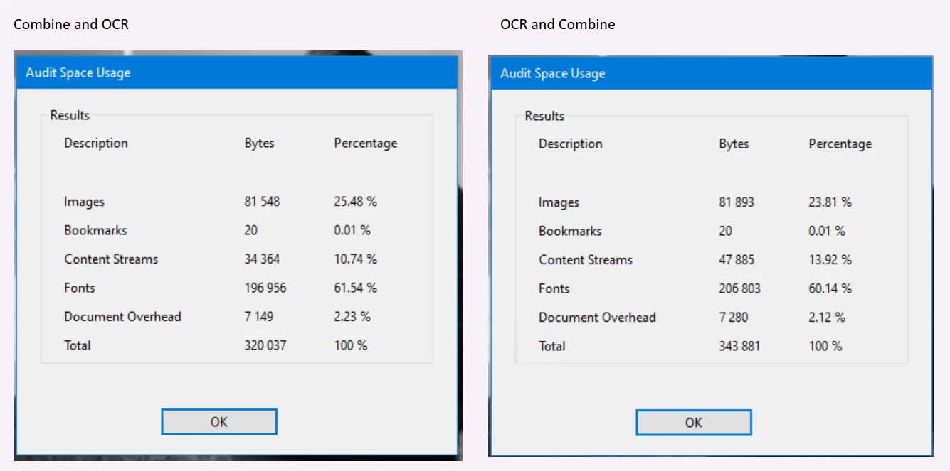

June 9, 2021
Hi gary_sc, thank you very much for all your tips. I did not know about TIF auto-OCR vs PNG... that's interesting.
I did indeed name my files in the right order.
I completed a 400 page report following both ways ("Combine and OCR" and "OCR and Combine") and the difference was significant. The former ("Combine and OCR") was 20% smaller than the later. Furthermore, the later gave a "The font 'Times New Roman-Italic-110869' contains bad /Widths" error when going through the PDF, which did not occur with the former.
It probably depends on the type of document (ration of images vs text, quality of the individual files, pre-preparation of the files, etc.), but it would seem that combining into one large PDF and OCRing after may not only result in a slightly smaller file for the same final quality, but also avoid strange font errors.
