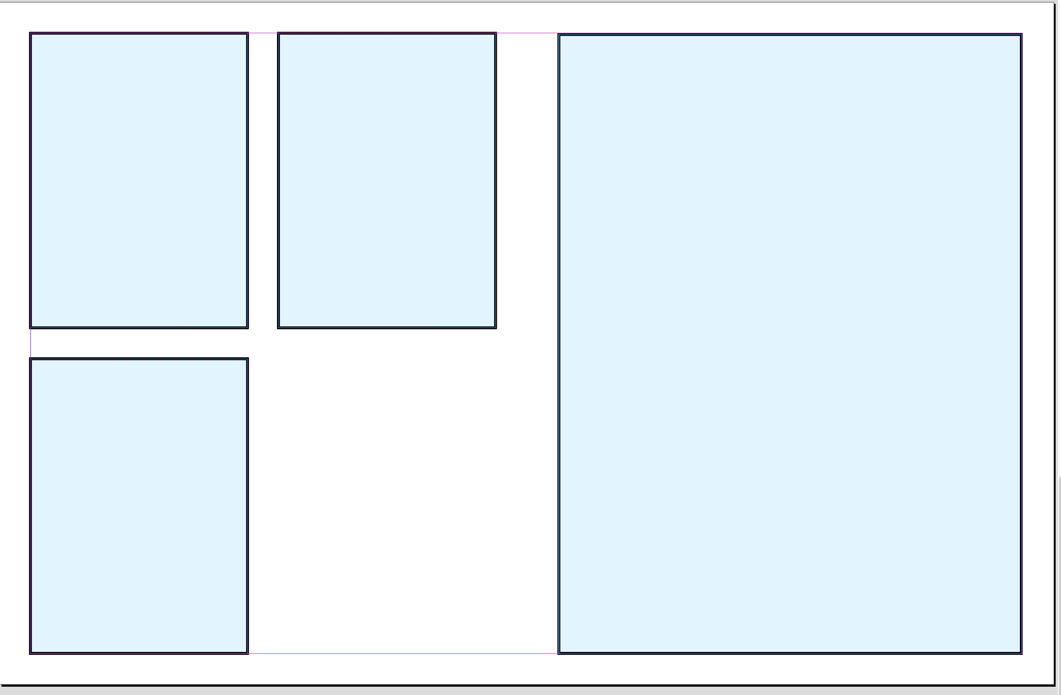

I have a document consisting of single pages which I want to view as a spread, but I want to combine multiple pages onto the left hand side (like if they are printed as 'multiple pages per sheet') and have only a single page on the right.
Is this possible? I'm sure I could go through a very tedious Print/Save as PDF process for the 'left hand' pages and then reimport them but it's a long document and I thought there must be a better way?

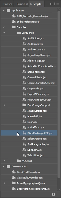

You can automatically place 4 PDF in one INDD page using PlaceMultipagePDF.
If it's not enought powerfull you can download and install the free script MultiPageImporter2.5

Sounds like I'm expecting too much of Acrobat. InDesign option seems pretty good, but it seems like a lot of manual resizing and moving images between pages is required - I have over 500 pages, 300-400 of them would be images needing resized.
I'm figuring the simplest option is to select my images in Acrobat's 'Organize Pages' layout>Extract (and choose 'Delete pages after extraction' option) and then I can save this with a number to denote how many pages are in that bundle eg. 'Monet-3.pdf', 'Gauguin-2.pdf'.
Then I can batch Print>Save as PDF all these files as 'multiple pages per sheet' based on the numbers i noted; ie. 1-4 will work on a quad split layout, 5-9 images on a nine-split layout. I can then insert these pages back in. Still a lot of manual work though. It would be great if you could just select a few pages and choose to merge them onto 1 page.

JR Boulay
August 11, 2021
Yes, InDesign is the best tool to do this, manually or using the PlaceMultipagePDF.jsx script.

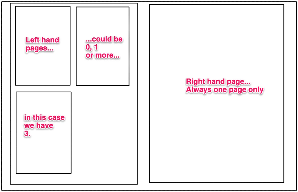

The PDF doesn't need to be interactive, nor scripted since I would be picking and combining the images manually and burning it all in to a new PDF.
Picture this scenario:
I have a bunch of PDFs, each of them has a biography of a famous artist, lets say: Monet, Gauguin & Van Gogh. These would be the 'right page'.
Then I also have some PDFs, each with an image of a painting by one of these artists. There might be 3x by Monet, 2x by Gauguin and 6x by Van Gogh.
I simply want to select the 3x images by Monet, and combine them onto one page (and make it the left page of the spread), and then select the Monet bio page and set it as the right page of the spread. There is no automation involved as I will be picking the pages manually...but as far as I can see, there is no straight-forward way to easily combine my 3x selected images onto one page.

I should clarify, I ultimately want to export a new PDF with this layout, so any 'view' in Acrobat needs to be replicated in the exported file.
The 3 pages on the left in my example sketch, contain information relating to the right hand page. I don't want to see any other pages on the left, that don't relate to the right hand page. So for Right-side Page1, I might have 2 pages shown on the left. When I go to Right-side Page2, there might be 4 pages shown on the left.
