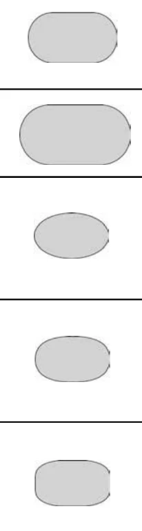

  • I have  to export file from InDesign as high-res, else it cuts some graphic so it will not show correct. See attached.
  • After that files is about 65 MB, but client wants it to be below 10 MB.
  • I have tried in Acrobat, to compress file. Also online on adobe.com, and on pdfcompressor.com
  • I have attached screenshot of graphic that is being cut, and the original Excel file.
Any suggestions how to do this?
Best from Jeppe

Hi, @jeppe_klausen, Thanks for sharing the image files. I think I see (at least) some of the problems.
How were these images created? They are extremely simple, basic shapes. I believe they distorted when you placed them into your PDF because you changed the size of the image, and they were bit-mapped images (created with pixels). Because the images were so simple, it becomes more challenging for any software to play "keep and toss" as to which pixels should be eliminated. In other words, by giving them greater resolution, you sort of helped the final image, but aggravated the size issue.  Here is a better way to do this (since I do not know how you created the images, the suggestion below may be immaterial.
Resize the image in Photoshop or a Photoshop-like application. To do this, let's say you want an image to be 1" wide, and you want the resolution to be 120–140 pixels per inch. When you save that, it will be 120–140 pixels across (and whatever the height ends up). Save this as a PNG-8, which will result in a storage size of approximately 1 KB.
But again, I do not know what you are doing or how.

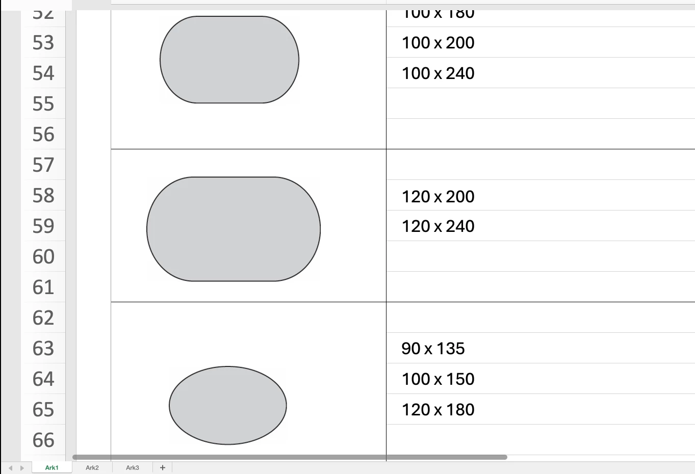

Hi @gary_sc
As you can see on attached screenshot here, the files looks okay in Excel.
I receive pdf-files from client, as I insert in InDesign, and then make a pdf with all pages (about 200 pages).
Maybe it is the pdf-files I get from client, that needs to be optimized..?

A way to resolve, is to replace ALL the drawings in the original Excel file to vector files, but that is a major task to begin!
