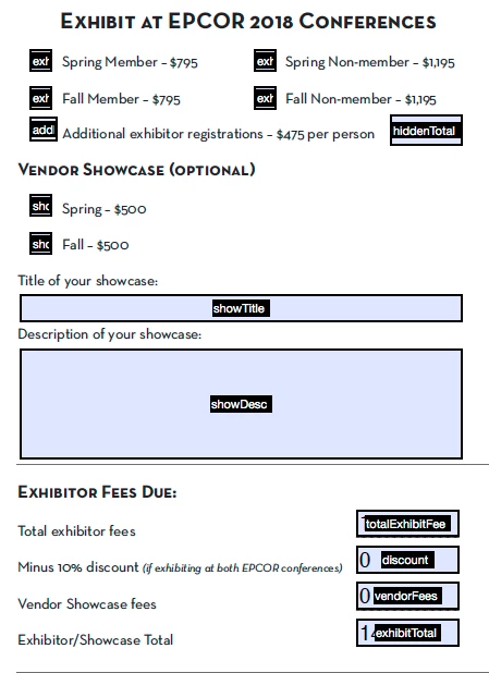

I have a form that is being used to register for exhibiting and sponsoring our conference. The user has the option to have a 10% discount applied to their cost if they exhibit at both conferences, but only if its both.
I need a calculation script that will apply the 10% discount if they select at least 2 of the 4 check boxes (spring member, fall member, spring non-member, fall non-member).
That amount needs to be placed in the discount box, so I can use its value to calculate the grand total. Below is my current setup of form fields.
Im not much of a scripter, so this kinda makes my head spin.
thanks for any insight you all may have as to how to make this work.

What are the actual names of the checkboxes?
Also, do you want the "discount" field to show the value after the discount, or the discount itself?
In other words, if the total is 100, should it show 90 or 10?
January 30, 2018
exhibitSpringMem
exhibitSpringNon
exhibitFallMem
exhibitFallNon
Those are the 4 fields that they need to have selected at least 2 of to get discount.
For the display of the discount field, I would like it to show what the cost is after the discount.
thanks for your quick reply.
