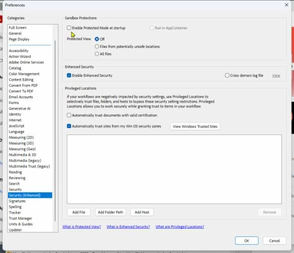

I read through this whole thread, and the step that got the images back for the original poster was turning off Protected Mode first. In Acrobat it's Edit, Preferences, Security (Enhanced), then uncheck Enable Protected Mode at startup, restart Acrobat, and convert the file again. It still won't lay out exactly like the PDF, the poster said the images came back scattered around, but they did come back.

Bernd Alheit
Dec 20, 2024 10:13 AM UTC
In the preferences of Acrobat disable the protection mode.
mala_2024Author
Dec 20, 2024 12:04 PM UTC
HI Bernd,
I did not enable security for the document. It shows no security.
Please guide on what to disable, thanks.
Bernd Alheit
Dec 20, 2024 2:30 PM UTC
Disable it in the preferences of Acrobat:

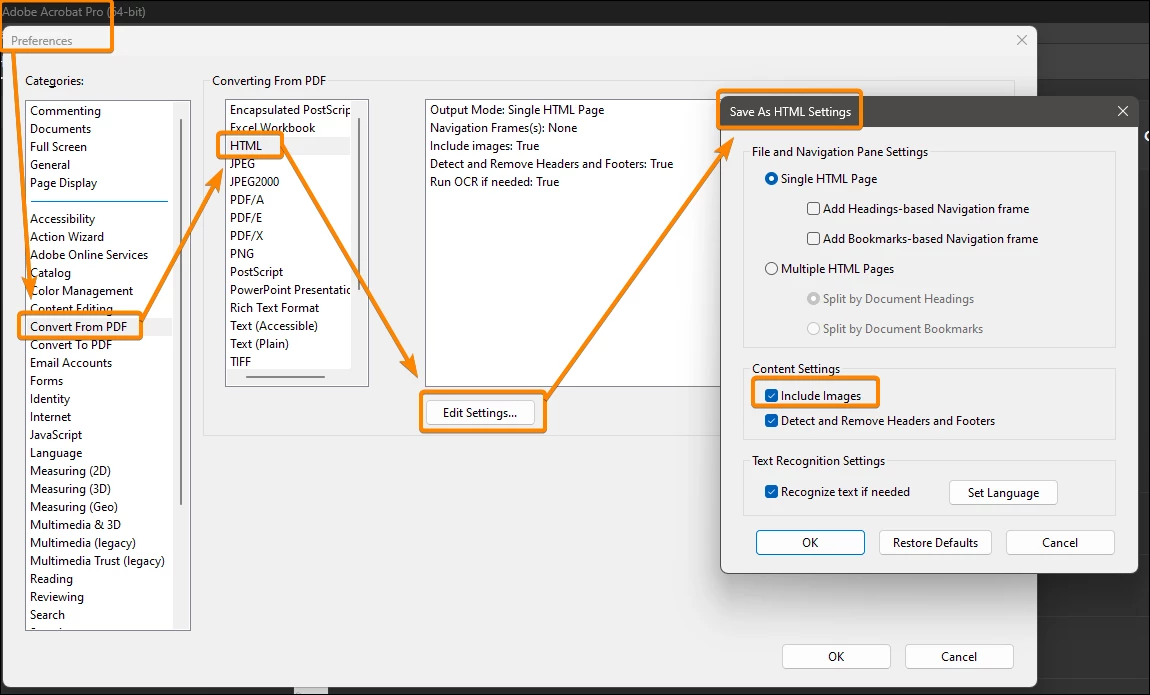

JR Boulay
Dec 20, 2024 9:32 AM UTC
It works fine for me with your doc.
Start by checking these settings:
mala_2024Author
Dec 20, 2024 12:01 PM UTC
Thank you for your response JR.
These are set by default.
When i check the preserences, they are already set.
Tried regenerating and see the same output without images.
