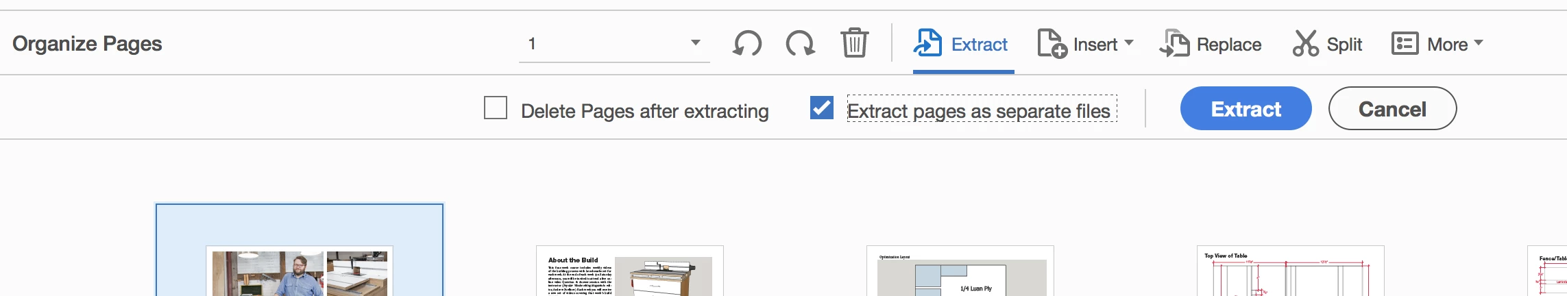

One easy way to get around this is to take your original document and break it into (say) three parts (pages 1–200, 201–400, 401– end.
You can do this by going into "the Tool "Organize Pages," and extract these pages (you will have to Shift-Click to select those pages). In the screenshot below notice that I'm extracting the pages as a separate document to make sure I do not do anything that could destroy the original document.
Now, process the three documents.
Then, also using the Organize Pages tool, you can combine them by opening the first document, and then inserting the 2nd followed by the third. Be sure to insert them after the last page of each. Alternatively you could also select from the File menu "Create -> Create from multiple files and do the same thing there.
Please let us know if this works.
