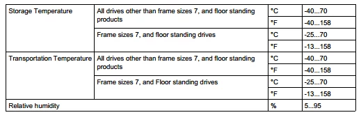

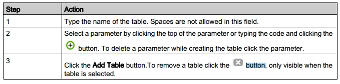

Hi community,
I got 2 questions on PDF to XML conversion:
1. Sometimes Adobe could not extract images (inline images) in a table. Like the button icon below.
2. To extract tables from a PDF, I think Adobe is currently using the 'Stream' method by default which may not identify a cell's colspan and rowspan (a cell of a table may span multiple rows or columns or both) properly. I found that 'lattice' method could be a better solution on this.
Are there any solutions available in terms of the above issues?
Thanks

    This requires a plugin written in C/C++.

    I'm not sure that "stream" and "lattice" methods apply to how Acrobat extracts table data. You're talking about a different tool?
    I have written table parsers for PDF. The tables you've shown above are simple ones. The lines are enough to separate out the bits. Tables can get very complicated and Acrobat doesn't come anywhere close to parsing even the simple ones.  You'll either need a special tool for this (and there are free ones out there) or spend a lot of time building a table parser yourself. Acrobat JavaScript could be used, but it is poorly suited for this type of task. For example, JavaScript could not extract the button icon in the first table, because content images are not available to the scripting model. A plug-in is what you need to do this in Acrobat.

    March 27, 2020
    Yean, I've tried some other tools for table extraction like pdfplumber, tabula, camolot, pdfminer, etc. I also tried to write a table parser in python. But they all failed on generality(tables we got are in high variation, and they can be complicated).
    Basically, our goal is to get the 'rowspan' and 'colspan' attributes of each cell. For example, the first cell should have 'rowspan=4, colspan=1' such kind of attributes. Could you plz share some sepcial tools(better to be free:) for solving this problem? Or can Acrobat JavaScript or a plug-in solve this to some extent? If so, can I get more details?
    Thanks
    Thom Parker
    March 27, 2020
    At this time your not going to get any better than the tools you've already mentioned, especially for free. There is a company that does high end AI based PDF parsing, but not only are they extremely expensive, I don't think they are much better than the open source table parsers.

    try67
    March 17, 2020
    Re your first question: What command are you using to extract those images? Could you share a sample file with us?
    March 27, 2020
    Thanks for your reply! For the first question, I tried to use the 'Export PDF as XML' tool. And I've contacted Adobe's customer service. They replied that they are trying to fix this issue, so let's hope for the best!
