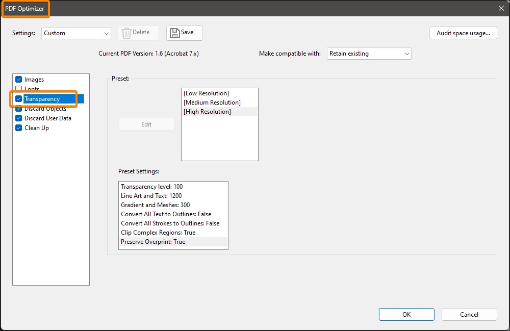

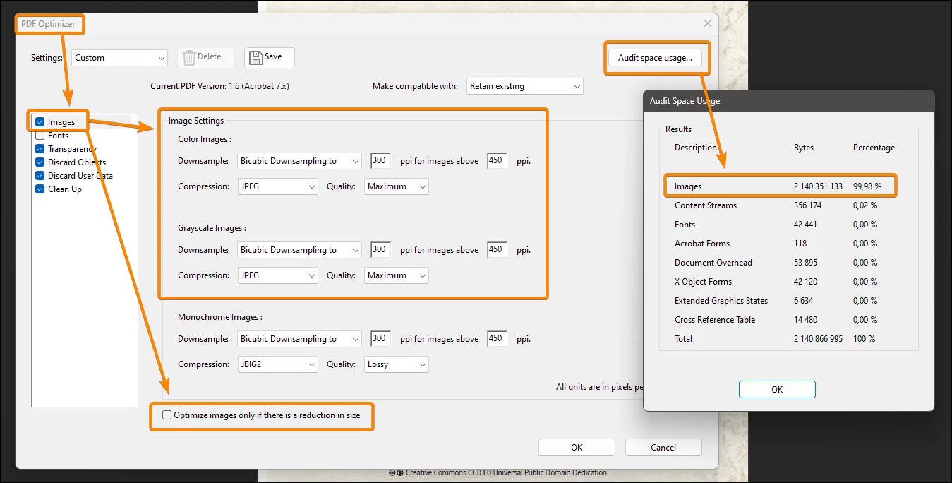

1. I used File menu : Save as Other : Optimized PDF (see settings on captures) and by using flattening (Transparency), even if it's not really necessary at this stage since it is required when converting to PDF/X3.
Audit Space Usage leaves no doubt about what takes up a lot of space in the file. I've used JPEG compression for the images because I don't think JPEG2000 is allowed in the PDF/X3 standard, but it doesn't change the file size much (I've tested it).

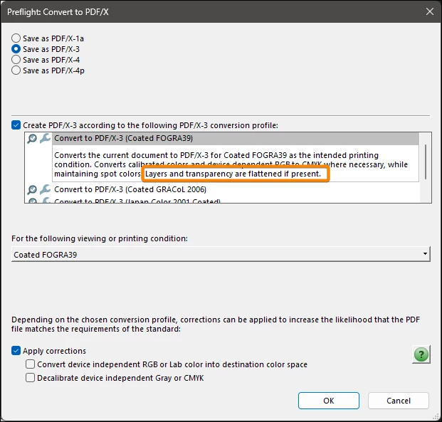

2. I used File menu : Save as Other : Press Ready PDF : PDF/X3 (see settings on capture).

Thank you JR! Advanced Optimization did the trick. Although I can't use it for flattening, because it doesn't allow setting the required blending color space, so I used the Flattener Preview tool for flattening and Advanced Optimization for downsampling.
I moved the flattening step before color conversion, used JPEG compression on color images and managed to get the file down to 501 MB.
