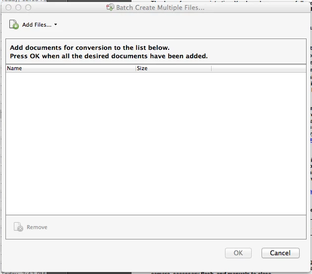

March 9, 2014
I'm using Acrobat Pro XI on Mac OS X. From the File menu I selected Create and then Batch Create Multiple Files...
You can either use the Add Files... button, or drag your files into the window.
I just converted 53 .doc and .docx files to PDF with no interaction.
- Rick
