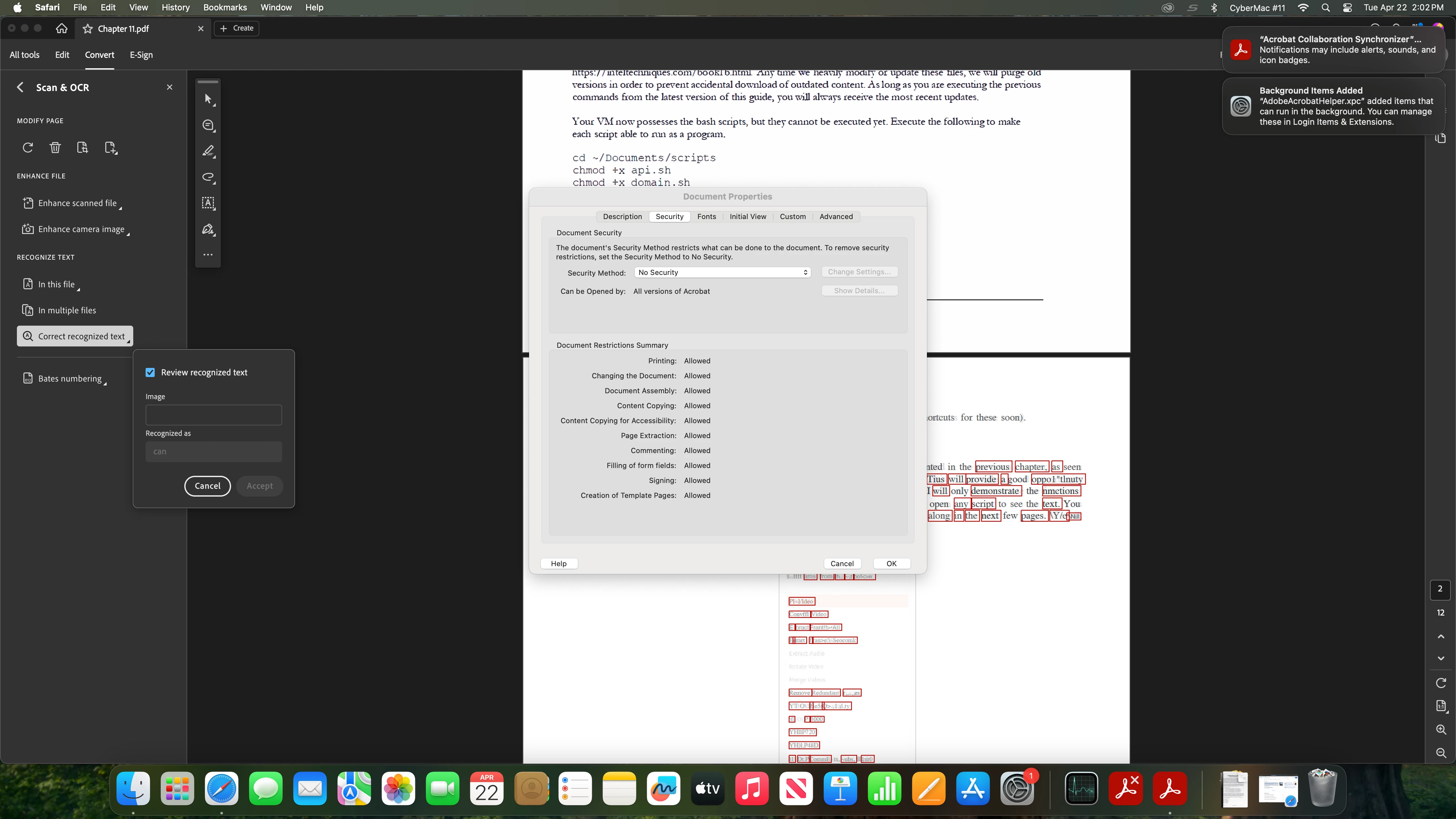

Hello all,
I am using Acrobat Pro on a iMac device. I used the Scan & OCR option to recognize text in the file, which it successfully completed. When I select the "Correct recognized text" tool, the pink boxes of questionable OCR also populates as expected. However, when I select the tool to edit the OCR text with "Recognized as," the option to edit the text and to accept those changes are both greyed out. I checked for updates and signed out and back into the Adobe account to see if those would fix the issue to no avail. However, my Windows installation works without a problem. Hopefully, someone will have a better idea as to what is occuring here and how to fix it.
Thanks!

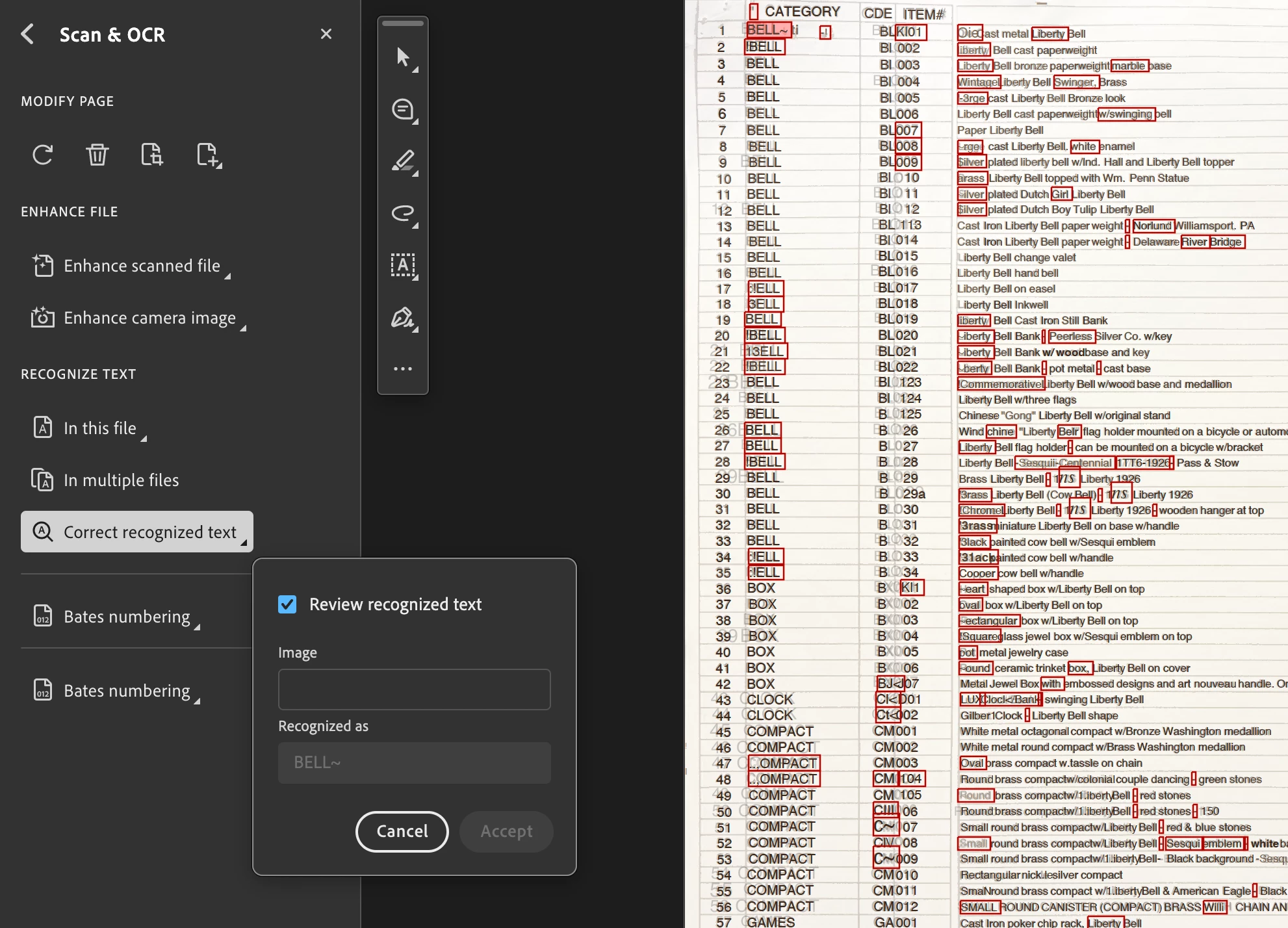

ivazq06
Nov 21, 2026 2:34 AM UTC
Running into the same issue! still not resolved and I am on Macos 27. I also had to revert to the old acrobat to edit the OCR text. Super frustrating that I had to go back to the old adobe to do it!

ivazq06
Nov 24, 2026 8:03 PM UTC
Hello
  • I attached 2 videos. One shows the current acrobat version with the issue and the other shows the old acrobat without the issue
  • the version number is: 2026.001.21563.0
  • The issue occurs with all files
  • the sample PDF is attached and titled “Adobe Sample”

Jun 4, 2026 3:19 PM UTC
I am experiencing the same issue. I want to correct the OCR so that this scan can become useable data. I have tried restarting; saving, closing, and reopening; and redoing the OCR. My version of Acrobat is Pro and also up to date. I am on a NEW Mac running OS 26.5.
ivazq06
Nov 24, 2026 6:52 PM UTC
go to view > disable new acrobat. open the file again > scan and ocr > recognize text > review recognized text. you will be able to edit! I had the same issue (new macbook Pro, macOs 27.0.1)

As described, the Correct Recognized Text tool in Acrobat Pro on your iMac isn’t letting you edit the OCR text, specifically, the Recognized as option and the accept checkmark are greyed out. As you've already tried the initial steps by checking for updates and re-signing into your account.
Please check the document restriction summary and make sure the document is not restricted from editing. Open the PDF > Go to Document Properties (Cmd+D) > Under the security tab > Check 'Document restriction summary'
Also, ensure the OCR Layer is Fully Editable: After running OCR, try saving the file, then closing and reopening it before using Correct Recognized Text. This can help ensure the OCR layer is fully committed and editable.
Check the language and font Compatibility: Go to Scan & OCR > Recognize Text > In This File, then check the Settings.
Ensure the correct document language is selected. Mismatched languages can cause Acrobat to grey out editing tools if it can't properly interpret the text.
Let us know how it goes.
Apr 22, 2025 6:35 PM UTC
Hello Amal,
I checked the document properties and saw nothing that should br restricting my ability to edit the recognized text. I have included a screenshot for your reference.
I attempted running the OCR, save, close, and reopen option without success. The settings for the Recognize Text were:
  • Document language: English (US)
  • Output: Searchable image
  • Downsample to: 600 dpi
I also attempted this using the output "Editable text and image" without success as well.
The computers with this issue (as there are two) are both 2021 iMacs (24 inch) with M1 chips, 16 GB RAM. One is running Ventura 13.5.2, the other Sequoia 15.3.
Any guidance would be appreciated.
