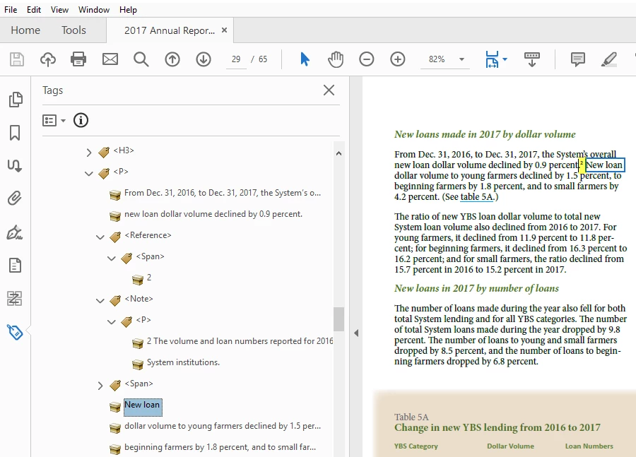

I would put the superscripted number in a <Reference> tag and the footnote in a <Note> tag. The <Note> should be placed as close as practical to the <Reference> without disrupting the reading flow, not left at the end of the page. The end result would look something like ...

No. Not unless the Reference tag has a combo of nested sub-tags called Link and Link-OBJR. This combo gives the link the accessibility required by PDF/UA accessibility standards.
But the hyperlink isn't needed because the <Note> tag just follows the <Reference> tag (after the end of the sentence, that is).
And to clarify the info above, you won't see the <Note> and <Reference> tags until the PDF is made. Publisher doesn't create the tags: it's the PDF conversion utility that creates the tags as it exports the PDF file itself.
Here's a screen capture of an actual file. You can see how <Reference> and <Note> are nested inside the <P> paragraph:
I haven't tested Publisher's accessibility within the past year, so I don't know where if it does this correctly or not. But the PDF shown in the above PDF was exported from Adobe InDesign CC:2019 which greatly improved the tagging of footnotes, endnotes, and table notes.
