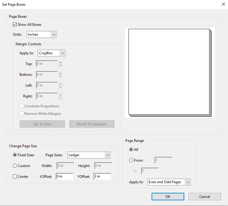

Hey! I found an answer which worked.
When it says the 'page size may not be reduced', this is because I was seeking to crop the page through the 'Change Page Size' section at the bottom (entering a custom size or selecting a fixed one), rather than the 'Page Boxes' section at the top (see image below):
If you need to increase the page dimensions, I've found change page size works great.
However, it seems the top section allows you to CROP by increasing the margins - thus cropping the page. If you have a page size in mind, you can check the 'constrain proportions' box and type in, say, '1' inch. Then take a look under the page preview on the right there and see your new 'Cropped page size'. Increase inch by inch until close enough to your desired page size to increase by decimal numbers until you get to your desired page size. It really isn't as complex as it sounds.

thinkdolphinweb
Again, this is an old thread but I found another work around that might help until Adobe adds an easier option to fix the margins.  Going through the action wizard you can still select the Crop Page option and view the command options.  In the page options, rather than setting custom distances for the margins, I selected one of the "Fixed Options" and this did not give me the same error.
I use this to save my course PDF's and edit them by hand on my iPad, the ledger size has been perfect, giving me a little more elbow room to annotate lecutre notes.
Hope this helps you or someone else who was frustrated.
