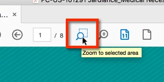

You must have selected the "Zoom to selected area" tool by accident:
To get back to the "normal" tool, you can select the "Hand" tool from the toolbar. If you've enabled "single key accelerators" in Acrobat's General preferences, you can also just hit the "H" key to switch to the hand tool.
