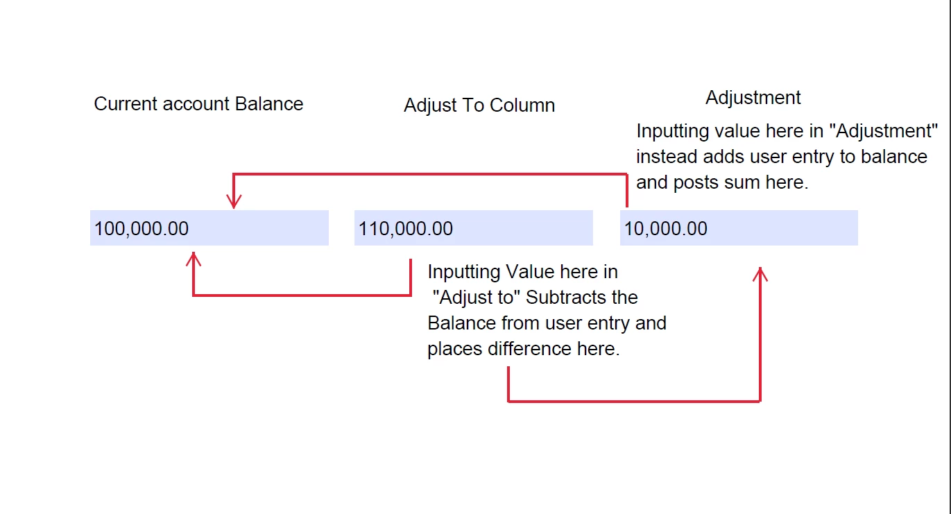

Here is a flowchart of what the pdf both will vaguely look like and highlights the intended functions

It can be done using one calculation script and check for event.source, but is a bit tricky because "Account Balance" is used in both calculations, so script should be set up to either only calculate second condition if "Adjust To" is empty and other fields are not or to calculate only when value is entered into "Adjustment" field (in which case you would need to enter value first into "Account Balance"). There is another way to use 'Custom keystroke script' in each field:
if(event.WillCommit){
//put script between brackets

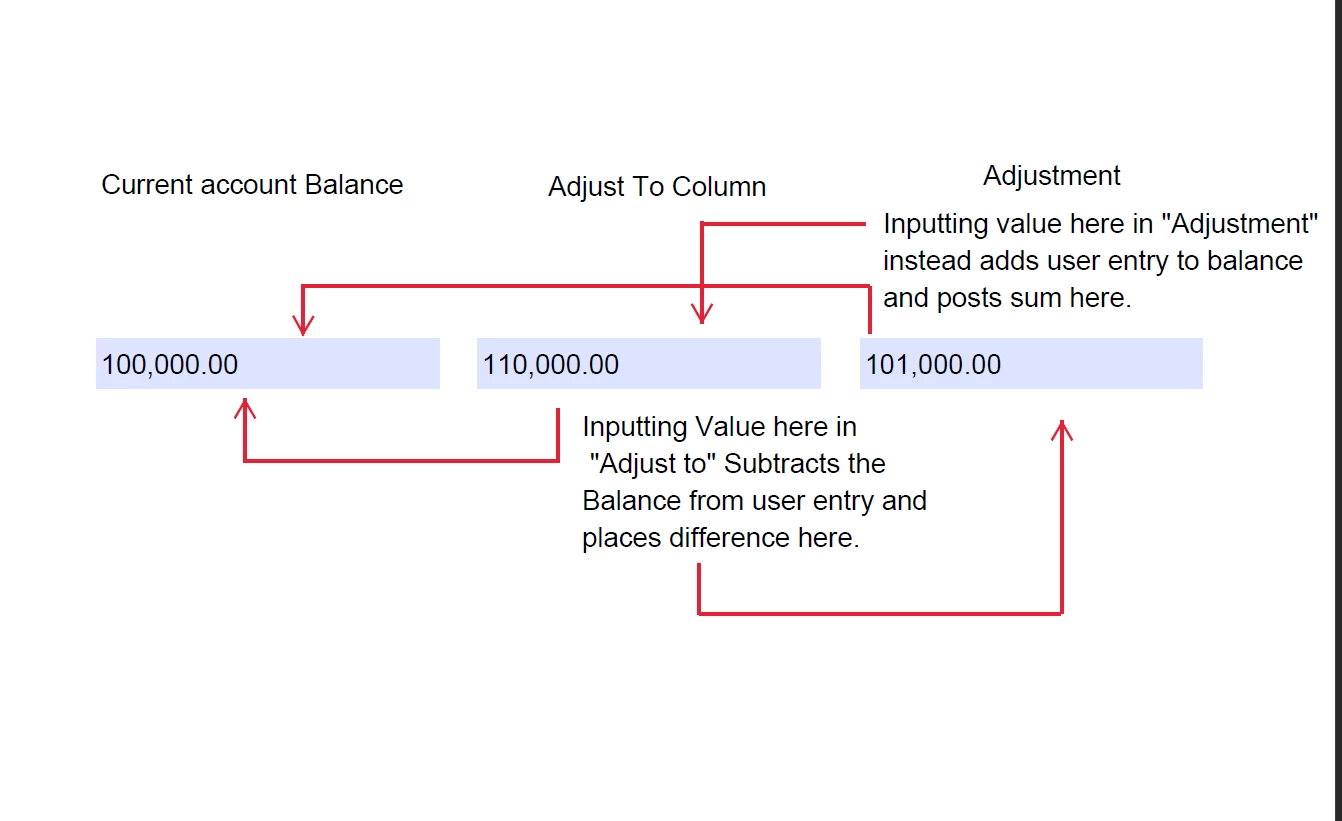

March 25, 2023
I realized the flowchart was missing an arrow, so it could be confusing so I fixed it.
