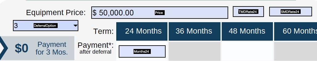

I'm working on an Acrobat Pro DC fillable form. The drop-down with two options is the condition and would like the Months24 field to calculate differently based on which dropdown is selected. The calculation is a basic dollar amount multiplied by a rate to output a monthly payment.
Below is what I'm trying to use in the Custom Calculation Script for the field I would like to be calculated (I was researching & testing what I found on these forums):
var a=+this.getField("DeferralOption").value;
if(a=="3") event.value=(Price*TMDRate24);
else if(a=="6") event.value=(Price*SMDRate24);
Here is a screenshot of my form:
Correct answer try67
You have a couple of issues.
1. If "a" is a number then you should compare it to numbers, not strings. So drop the quotes around "3" and "6" in lines 2 and 3.
2. You have to access the value of a field like you did with "DeferralOption". You can't just write its name, like you're doing with Price, TMDRate24 and SMDRate24.

Thank you, this fixed it! If I instead list "3 Months at $0" & "6 Months at $99" as the drop-down options and in the formula for If & Else, do I need to have the "" around them? If so, is there something else I need to do to make this work? When I tryp adjusting the options as such, the code doesn't work. Worst case, I'll just still with 3 & 6, without the "", as you advised. Thanks again!
try67
August 9, 2019
Yes, then you have to use quotes, and remove the "+" from the first line of code.
