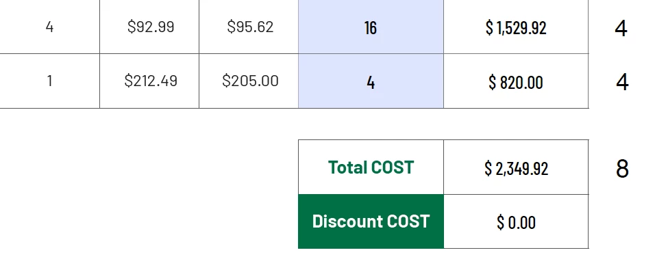

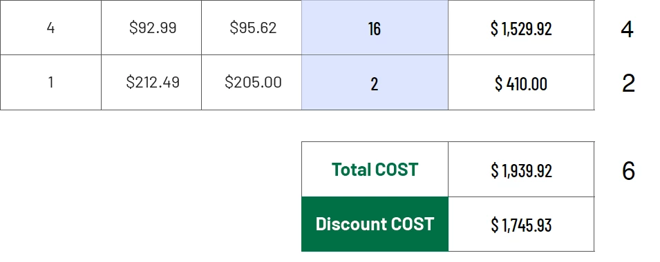

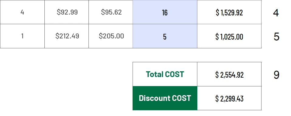

Still having some issues with the discount cell. Attached is a video showing what happens when values are entered and changed. The column on the right is my invisible Case Qty tally.
Thanks again.

April 12, 2023
Thanks for the quick response, JR.
Still having issues with the discount not showing up for exactly 8 cases purchased, also the discount being applied to the cell when conditions are initially met then changed so they are not.
