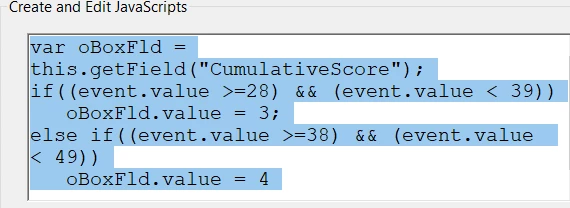

October 30, 2023
The Cumulative Score field is a calculation script to add 11 fields together. That calculation works. I've tried copying the above and putting it into the validation script but nothing populates when I test.

So there are a few issues, mainly that the script needs to be placed in the correct location, and reference the correct field.
For example, the calculation is in the "CumulativeScore" field. So the validation script can't set that value, cause it's already calculated.
I believe that it is the "Overall Rating" field that you want to set? These are the kind of details you need to tell us, cause you know, we can't read minds.
So put this script in the Custom Validation for the "CumulativeScore" field.
// This script goes in the validation for the "CumulativeScore" field.
var oBoxFld = this.getField("Overall Rating");
if((event.value >=28) && (event.value < 38))
   oBoxFld.value = 3;
else if((event.value >=38) && (event.value < 48))
   oBoxFld.value = 4;
else
   oBoxFld.value = "";
Thom Parker - Software Developer at PDFScriptingUse the Acrobat JavaScript Reference early and often
