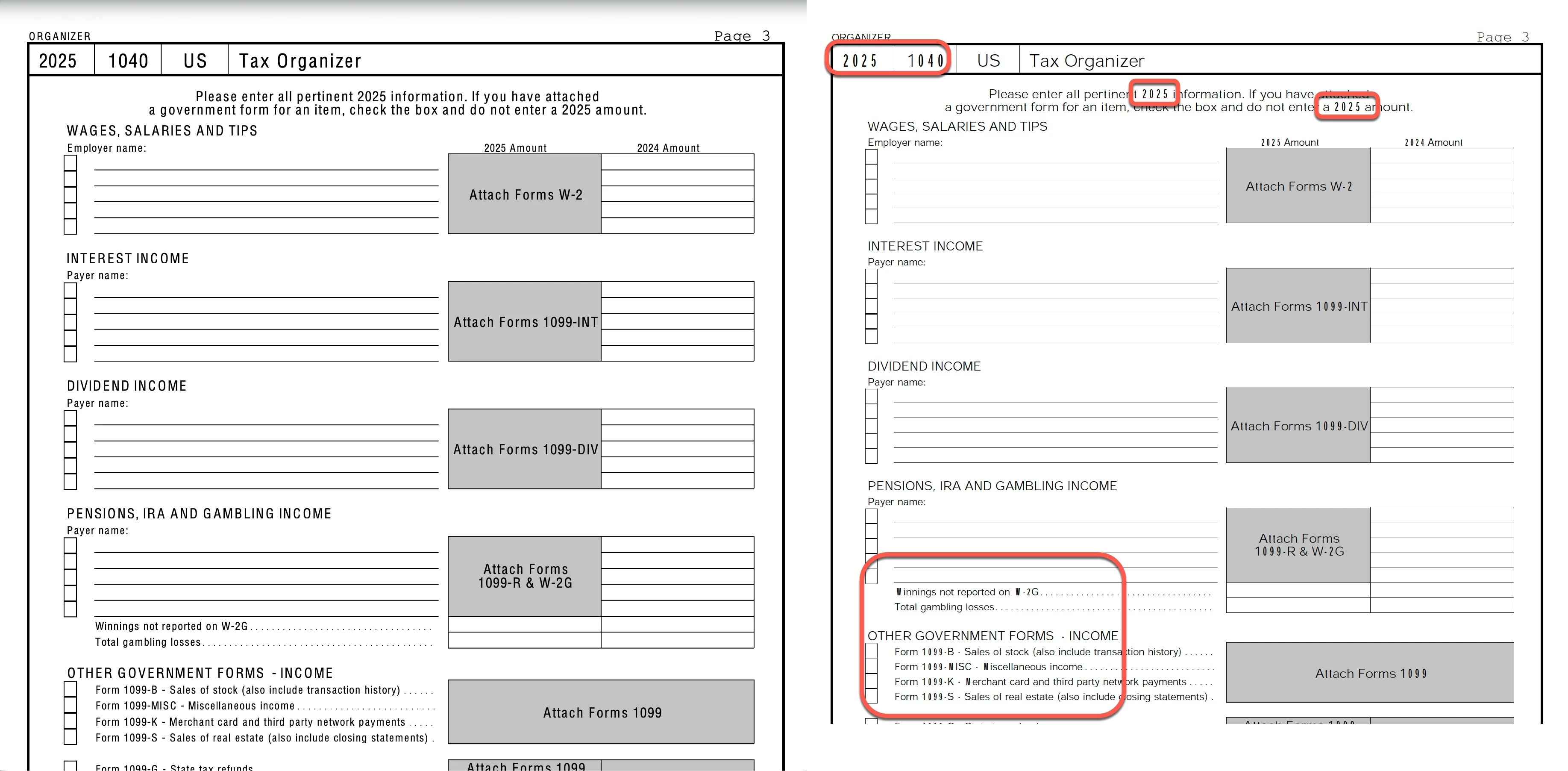

    When I open the attached pdf, it looks normal in Preview (on the left in the screenshot below), but in Acrobat, the numbers and the letters M and W look weird (on the right in the screenshot below). Is there a font I need to install?

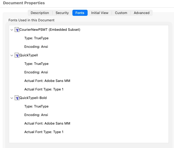

    This is what Document Properties on this document says:
    Do I install QuickTypell? Or Adobe Sans? Where do I find Adobe Sans? I went to:
    fonts.adobe.com but I couldn’t find Adobe Sans.
