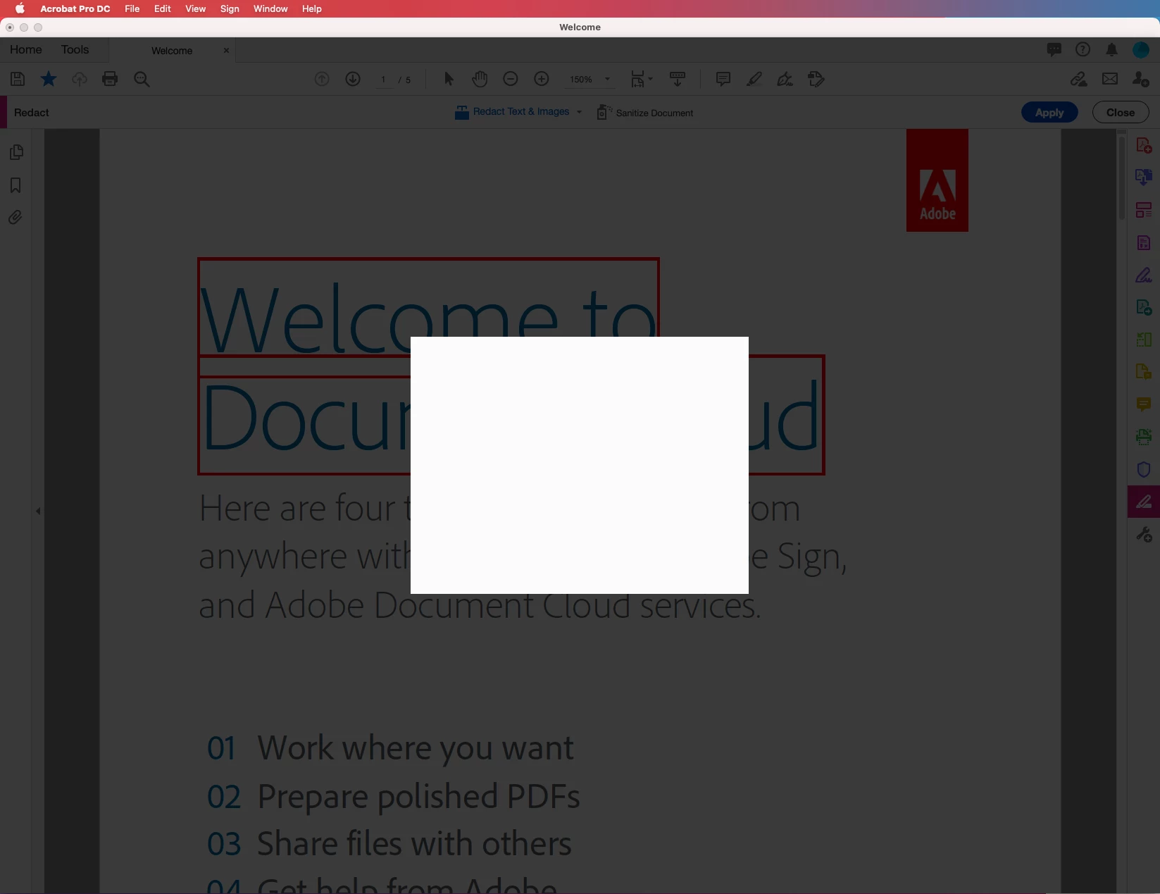

Hi Adobe Support Community,
When I try to apply redactions in Acrobat, a blank dialog appears with no option to confirm the redaction. Screenshot attached. A few notes:
  • The problem is reminiscent of the blank "Save As" dialog that appears if the "General > Show online storage when saving files" option is enabled (as it is by default). However, the recommended workaround of disabling that option does not seem to help in this case.
  • I can exit from the blank dialog by pressing "Escape", but pressing "Enter" does nothing.
  • This is not about the file I'm trying to redact being locked or signed. It's neither. As can be seen in the screenshot, this happens with the "Welcome to Document Cloud" example PDF that ships with Acrobat, and indeed with any PDF.
  • I've tried uninstalling and reinstalling Acrobat, to no avail.
I'm using Acrobat Pro DC version 2021.001.20135 on Mac OS X Big Sur version 11.2.3, on an Intel-based Mac Pro from 2019.
Help would be appreciated as this is a breaking issue for me, with direct financial penalties (I can't submit unredacted credit card statements as evidence for reimbursements...)
Correct answer try67
- Try running a Repair Installation from the Help menu.
- You can apply redactions manually by running this script, from the JS Console or a menu item:
this.applyRedactions();

Hi, this worked for me. Go to Edit, Preferences and then find Security (Enhanced) down the left hand side. Uncheck 'Enable Protected Mode at Startup' at the top and then close Adobe. When you go back in the blank boxes should work again.

try67Community ExpertCorrect answer
March 12, 2021
Ian5D8DAuthor
March 12, 2021
Thanks. For the record, there isn't any "Repair Installation" option in the Help menu in my version of Acrobat. However, enabling the JavaScript console and then calling this.applyRedactions() worked.
