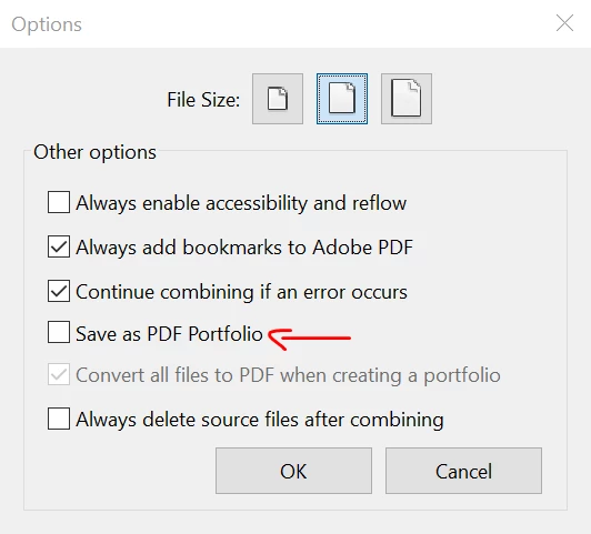

If this helps anyone that didn't already know, I was advised of a way to keep the signature on combined documents.  After you open the document, hit combine then you hit the options button (gear icon), the option with the red arrow pointing to it (Save as PDF Portfolio) helps you keep the signature.  This is something they informed me, I haven't had a chance to test it though.
