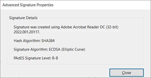

The reason why Adobe Acrobat validates this signature positively in spite of this incorrectness is a well known Acrobat error: For signature validation it ignores the contents of the signature algorithm field of the signature container SignerInfo object and deduces the algorithm to use from the public key of the signer certificate.
It does use the contents of that field for displaying an alleged signature algorithm in the Signature Details (Signature Properties -> Advanced Properties), though, and so misleads users who want to check the strength of the used algorithm here!

The same is happening in Adobe Reader DC, latest version. The same is happening using simple adbe.pkcs7.detached signatures, but this is of no use in EU since qualified e-signature has to be in advanced format, for PDF this is defined as PAdES-BASELINE B, T, LT or LTA levels. Since the same problem is present in latest version of Reader I guess there is no use in upgrading Acrobat 2022. In fact, I gave Acrobat as an example since the Reader is not supported.
