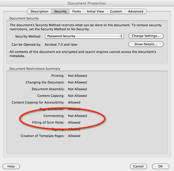

October 5, 2011
It's just a matter of setting the appropriate restrictions when setting up password security. You can allow form filling but disallow commenting.
October 5, 2011
Hello George,
Thank you for your response.  I did set that security setting but when I then went to the Save As... Reader Extended PDF it over wrote the settings.
I was able to get around this by saving the document normally and then reopening it in Acrobat Pro and then doing the Save As...Reader Extended PDF and it kept the commenting option disabled.  I am not sure if this is the proper way to achieve my goal, but it works and I tested it in Acrobat Reader with success.
Thanks again!
