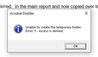

I have several users getting an access denied Distiller error after updating Acrobat DC to version 25.001.20458.
The error pops up randomly even when Acrobat is not in use. I have tried removing DC, running the cleanup tool and reinstalling DC. I also apllied the latest optional update 25.001.20474.
I have cleared all temp folders and granted users full control over all Adobe folders, c:\windows \temp and c:\temp.
I also tried turning UAC from off to on but the error still comes up intermittently. Has anyone else has this issue?

We are live with a new update (25.1.20xx), which has a fix for the issue.
Please update the app and let us know if the issue is fixed for you.
More info here: https://adobe.ly/3V38zfs
Let us know how it goes.
Souvik.

For testing purposes, close the Acrobat app, then open Task Manager, and close the "Acrobat Collaboration Synchroniser" process, restart the computer and check if you are getting the error message.

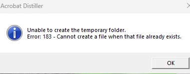

got a new error when updating Acrobat DC to version 25.001.20643
Error 183

just had this error appear, I dont run a big IT department, just was sending an email and the "Unable to create a temporary folder Error 5 - Access is denied." appeared.... thought it might be a virus or something. no clue...
