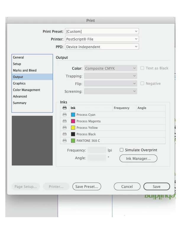

I do have a rip called Genie Jet for polyester plates that print on an Epson P800. I choose not to use the rip for most my simple jobs because it can take 10-20 mins. per color per plate. So, I discovered that I can use the same plate material in my Canon C710 in about 30 seconds but there is no rip so I must do the separations myself. Most of the plates I need are simple 1-2 color jobs or simple line art. If there is any trapping to tight registration I will still use my Genie rip.
I do all my layouts in Indesign and for some reason can not make a separated pdf from indesign as you indicate in your response. The Canon will only allow me to import or print a PDF file. So I am forced to output a PDF from Indesign then open the PDF and save as a PS separated file and at that point I would distill it to get a separated PDF file to print to my Canon.
Perhaps I don't have the correct PPD to make the separated file straight from Indesign? When I try to do as you suggested it seems to print but to a non-existant printer, see attached #1. Or it won't let me select separations as a PS file, see attached 2.
I am very willing to try anything you think may work for me. Thanks for your response and I look forward to hearing your thoughts.
