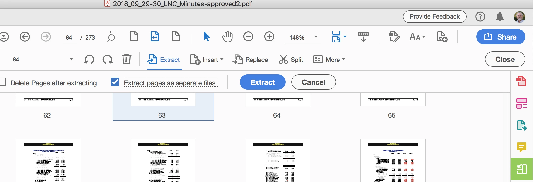

It looks like PDFElement will do this - I wonder if you have any experience with that.
gary_sc
December 16, 2018
Hi Carynd,

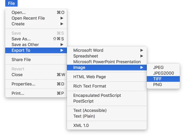

You already have it: Acrobat DC Pro. One BIG suggestion: be sure to export this into an empty folder. Otherwise you'll have (in the case of the document you sent me) 273 separate TIF documents. (continue below)
And if you want to save them as PDFs, select the Organize Pages tool and select the following.
But just out of curiosity, why do you wish to save them as TIFs? What workflow are you considering?

Yes I downloaded - thank you.   Do you know a program that can take a PDF and export it in one step into separate TIFFs for each page?

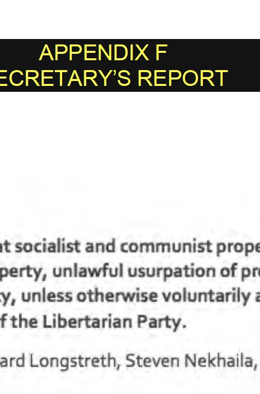

You do not say how this was scanned, nor using which version of Acrobat on what kind of computer nor with which scanner.
Nonetheless, I downloaded the document and verified that yes, not all of the document was converted into searchable text. So, I opened the document on my Mac and ran Text Recognition from the "Enhanced Scans" tab of tools. It took about 10 minutes but I know have the complete document fully searchable.
I am curious as to what your process for making this document because things you have on the top of a page (e.g., Appendix F Secretary's Report) are obviously digital text, the text below that is scanned text that is highly JPGed with lots of degradation. If you look at the screenshot below and look at the black on white text, you'll see a lot of gray splotches all over the place. That is JPG degradation that is caused by the JPG lossy process. This degradation will also degrade the quality of the OCR process as it can confuse the optical reading of the text.
In a word, generally never use JPG as a format for saving unless you are using zero compression. But this was heavy heavy compression, perhaps set as low as 30%. FWIW, the size of the document during scanning will have NO BEARING on the size of the final PDF. When I scan my documents and save as TIFs, each page is typically around 8-9 MB but after saving them as PDFs and creating searchable documents, the page sizes are around 40-50 kb.
Most of the above has nothing to do with your original question but perhaps it might lead to some of the issues you may be having. I would appreciate your letting us know what is your scanning-processing approach and we might be able to help you avoid these issues in the future.
