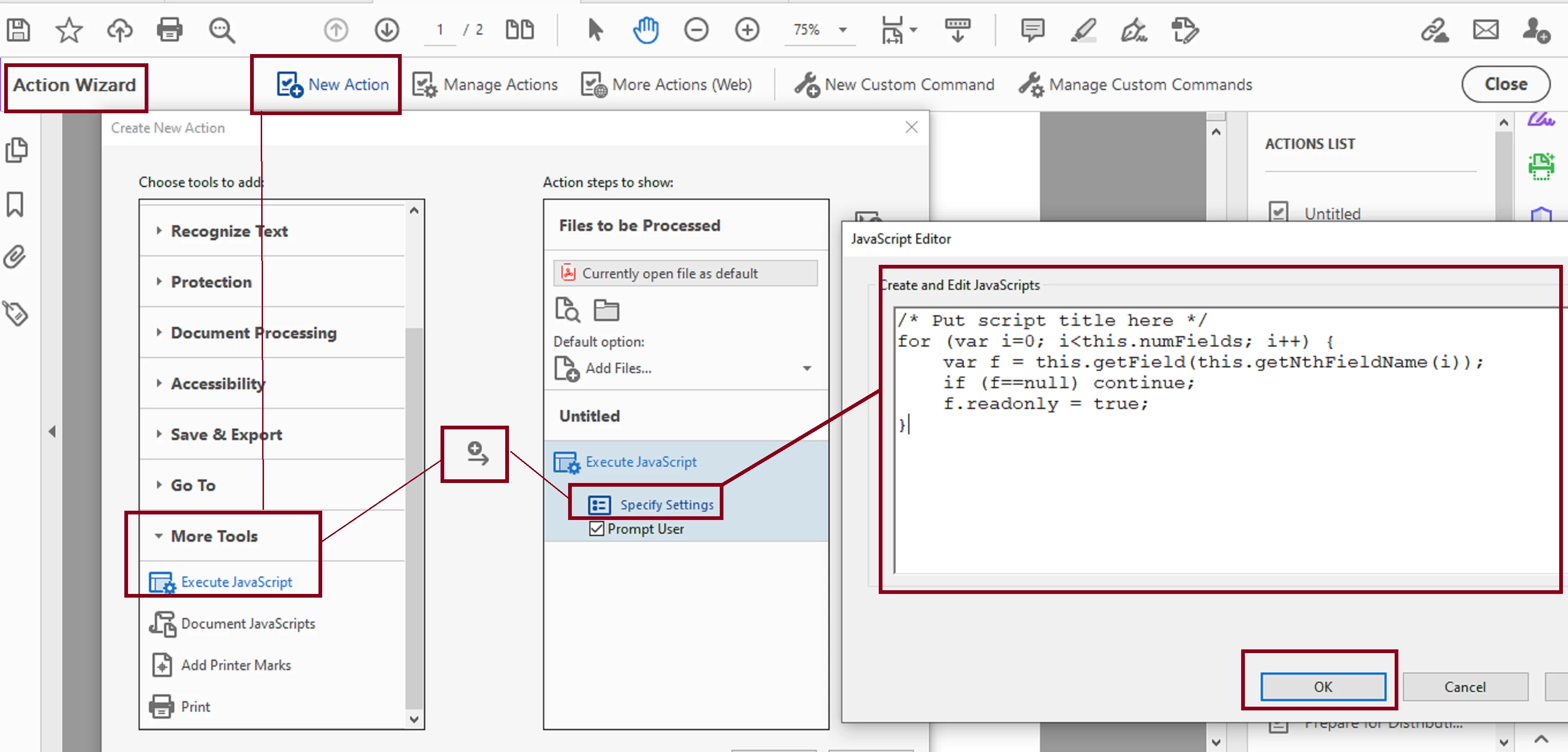

With Acrobat opened, go to Tools and select the Action Wizard Tool.
Create a New Action as shown in the slide below:
And copy and paste the following script in the Javascript Editor window as shown above:

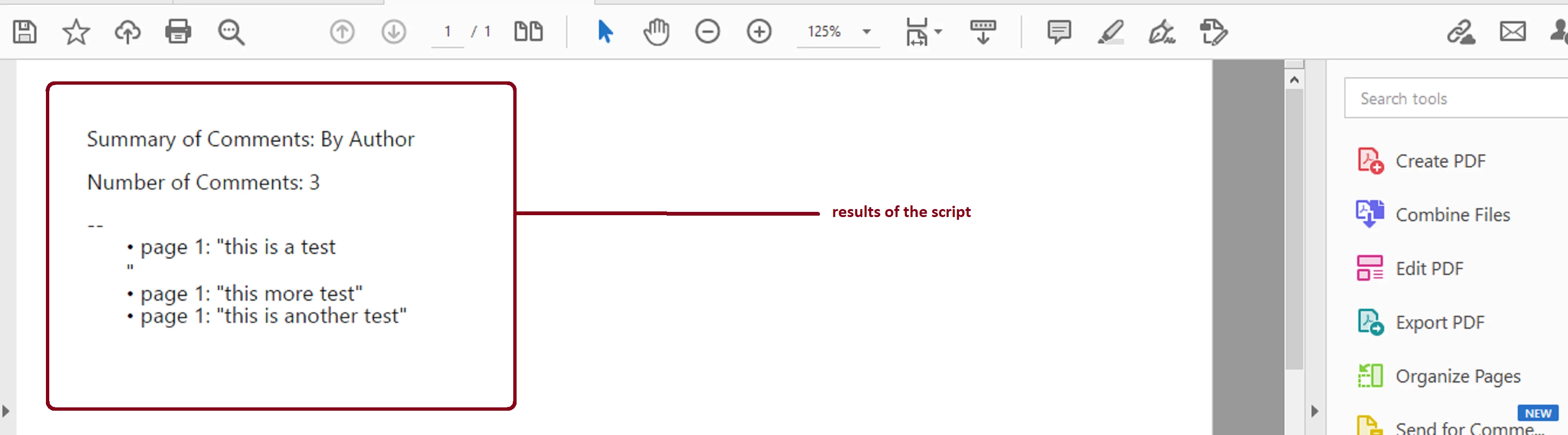

The script abobe decalres a variable with the function, "new Report()", and in the example it will generate a report consisting of a summary of comments filtered by Author, the number of total comments per Author(s), the messages that the commenter(s) posted and the page number where the annotationns or comments were added.
See results below:

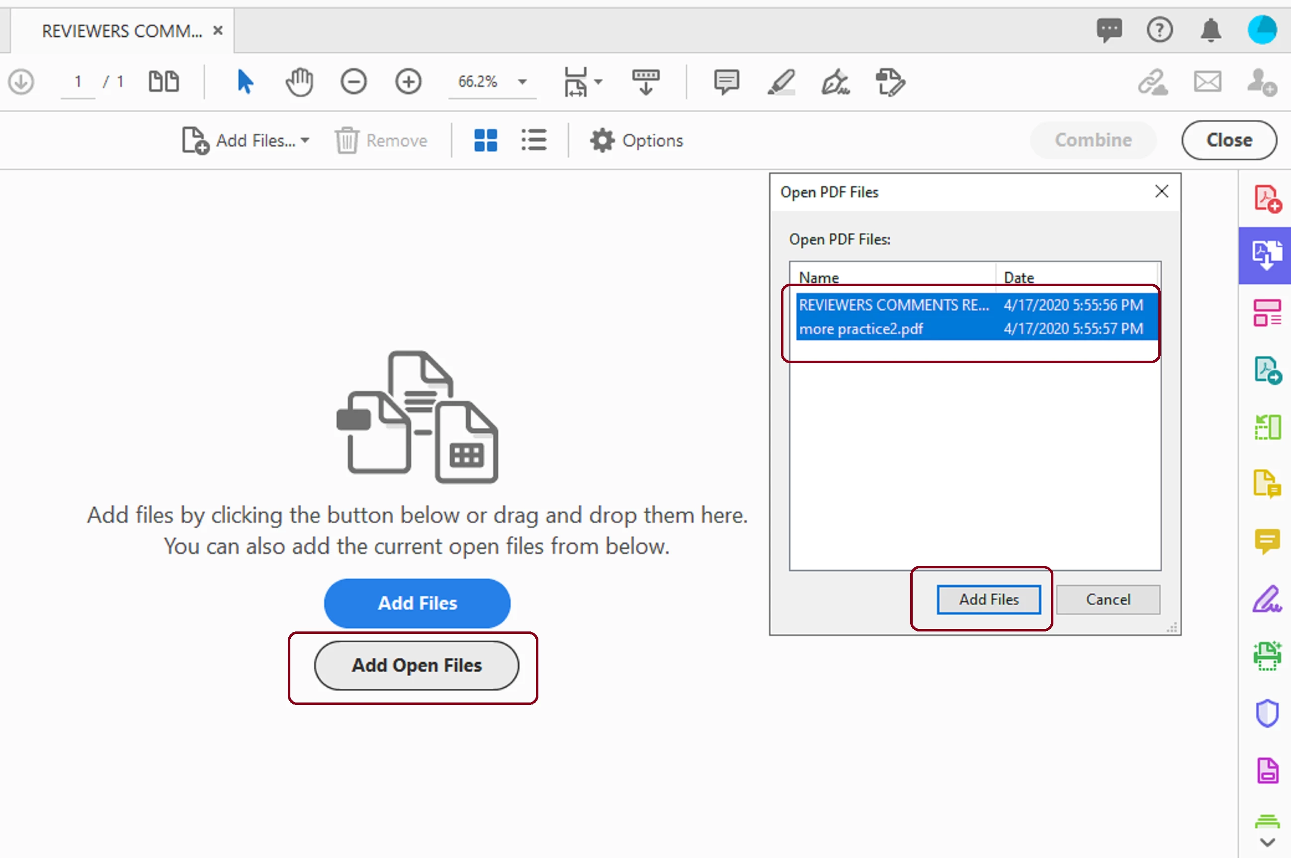

If you prefer you can also merge this report to the original file,by using the Combine Tool as an action added right after the javascript action. After the jscript action executes  it will open the combine tool wizard.
 See below:
This will save the newly merged document into a PDF binder. Note that after you click on "Add Files" it will bring another dialogue box where you can also customize the new binder filename with an appended prefix, for example; making it easier to find this reports and not confusing it for the original source PDFs.
