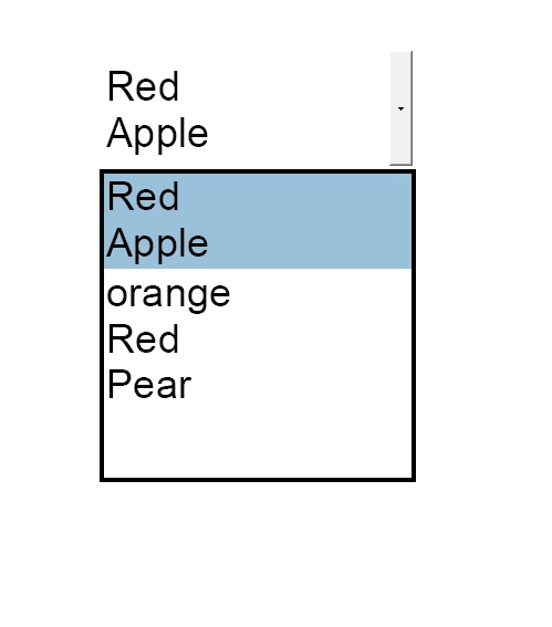

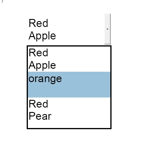

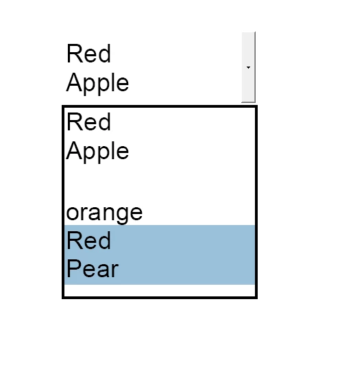

The code provided by Thom is correct, and is the only why of doing it. This is what it looks like (notice the buggy way in which the "pear" objects moves around):

try67
September 10, 2018
I would advice you don't do that. It's an undocumented feature and it doesn't work very well. You'll notice it behaves strangely when you select an item with a line-break.
Thom Parker
September 7, 2018
Do you mean an actual popup menu, or do you mean the ComboBox(DropDown) form field?
In the first case, the popup menu does not support multiline items, but the dropdown form field does. The multiline entries are added with a script, like this:
this.getField("Dropdown").setItems(["Red\nApple", "orange", "Red\nPear"]);
The first and last entries use the newline character "\n" to create two lines in those entries.
