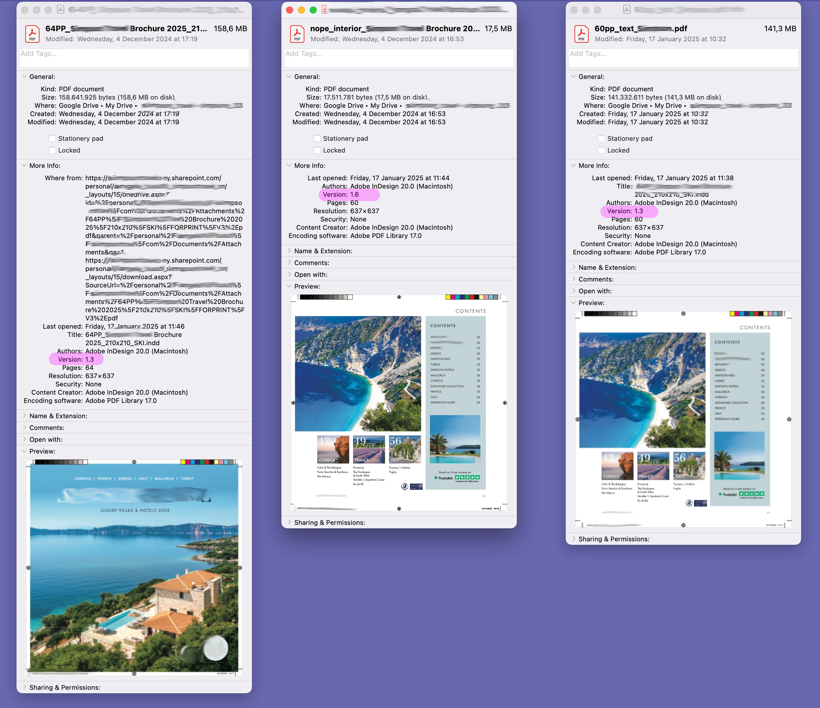

stickleback25
Jan 27, 2025 4:53 PM UTC
Hi - all 3 versions are at the same size - 224mm x 224mm which is the page size of 210 x 210 with the bleed added.
The original file and the later test file are both at 1.3 (version 4.x)
The "funky" file is at 1.6 (version 7.x)

stickleback25
Jan 22, 2025 11:24 AM UTC
So - I can share this screenshot..... going left to right.... the first document is the original file received from the client (the date stamp is in their UK timezone) I edited to remove pages 1, 2, 63 & 64 because they were to be used on the cover spread file. And I saved it (I added the "nope" a couple of days ago so as to be sure not the use the file in the reprint) that's the middle file.
After they brought the error to my attention and did the same thing again - which is the test file.
Three things I notice... the original file is 158.6MB - the test file is 141.3MB - which removing 4 cover pages would be about right. The middle file is only 17.5MB - so clearly something changed.
The second thing I notice is that the Resoluion of 637 x 637 is the same across all three files but...
the third thing is that the first and last are saved as Version 1.3, the middle one at Version 1.6
Aas far as I recall - and what my normal practice would be in this case - would be to open the file, use the Edit pages tool and delete the pages I needed to delete - I would then Save As and simply rename the file.
As far as I can see there are no options in that process to change the resolution or anything else - and in fact, even if there were - why woud I.... as a print broker my one explanation for anything that goes wrong in the print propcess is that I have used the files supplied to me.
In this case this is costing me for the reprint. I cannot see how it's anyone else's fault and even though I can't see how it's mine I am having the acceot the responsibility and the loss.
