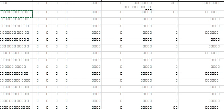

I had a problem when I tried to convert 1 PDF file to excel, and the result showing
not in numbers. How to shoot the problem?

This has nothing to do with the question you posted under. Create a new thread, and provide the full details of your issue.
