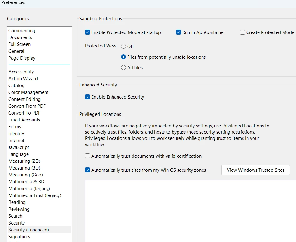

I'm using Acrobat Pro 2023 in conjunction with MS Edge to open pdf files on a webpage. The Edge browser locks up when I attempt to open the PDF and the PDF does not open. In Adobe Prefernces I tried turning off Potected View and that resolved the issue. I'm concerned that this method may pose a security risk. Is there somehting else I can try to resolve this?

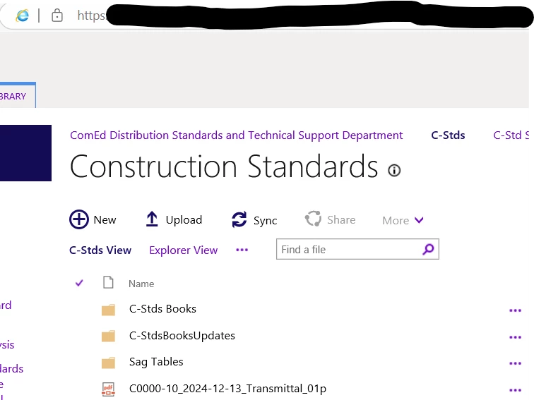

Below is the web page where the PDFs are selected. The c0001- 10_2024-12-31_Transmittal_01p PDF at the botttom of the screen print is one of the ones I've been testing with.
If I leave the default Preferences setting to "Files from potentially unsafe locations" selected then the PDFs will not open. However if I change the selection to "Off" the PDFs do open. I'm concerned that leaving it in the "Off" selection will create a security risk.

I added a the website to the Priveleged Locations and that seems to have resolved the issue. I also left the Files from potentially unsafe loacations selected for added security.
