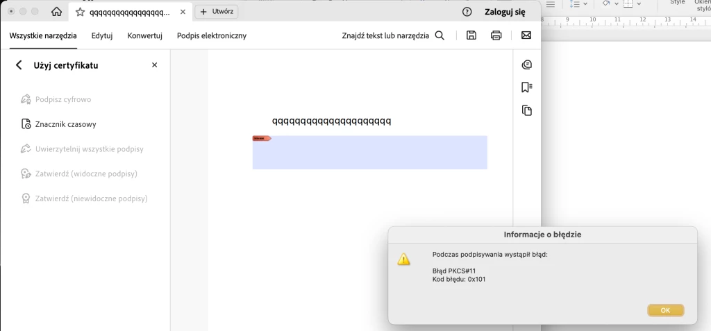

I have a problem signing a document in Adobe using a qualified signature, error pkcs#11 is displayed. I removed and added the module again but no change. Where is the problem? This signature worked before.

I work on Mac. This is a cloud signature. It works on the /usr/local/lib/libencardp11.dylib library. The signature worked in Adobe but suddenly stopped. I reinstalled Adobe, reinstalled the signing software, removed the module, added it again. The signature works fine through the signing software.

Sorry for the troubled experience, based on my findings on the error code:
Error 0x1011 typically indicates that the token or certificate is not accessible, which can be due to:
  • Token not inserted properly
  • Smart card reader not detected
  • Token middleware (PKCS#11 driver) not installed or not recognized
  • Incorrect configuration in Acrobat’s Digital ID and Trusted Certificates settings
  • Outdated token drivers or conflicts with other cryptographic software
