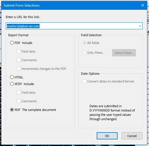

I use JavaScript and I posted the code above which has worked fine up until we switched to web-based Outlook365. I am having trouble getting the Outlook365 to compose an email with the selected email address on the pdf to send the pdf as an attachment.
I tried the open web link action but that only opens the web based Outlook365 and no a "compose email' window. I'm not worried about the server based Outlook anymore since all users will eventually be migrated over to 365.
Any recommendations on how to fix this?
May 21, 2024
I have tried the Action-submit form but it lets me only designate one email address.
I have a dropdown on my pdf document that selects different locations and attached to each location is a unique email address. When on the old server based Outlook, it would email the form to the selected email address. based on this dropdown I have no such option with the submit form action.
