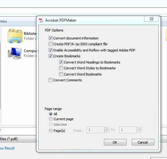

1. I designed a document in Word file where I attached some Visios charts. But they were huge in size. So, I exported each Visio Chart as PDF and insert a PDF icon for each. Everything was OK but the client wanted to email the document as PDF not as a Word file.
2. I saved Word file as PDF. No option related to links. See attached.

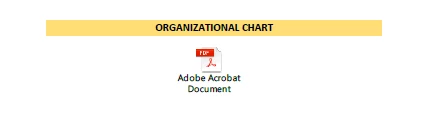

I ended up with a PDF looking like this one. No icon was an active link as it supposed to be.
So, I tried the aformentioned steps.

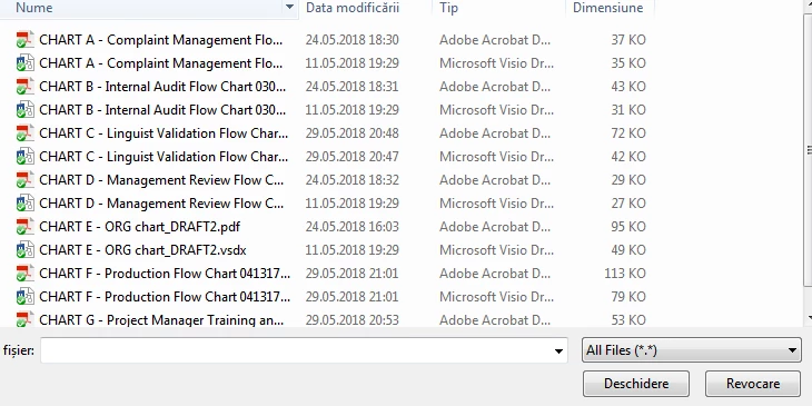

1. I opened Attachments tab. See attached.
2. I clicked add a new attachment icon. It opened a window from where I could locate and attach any PDF.

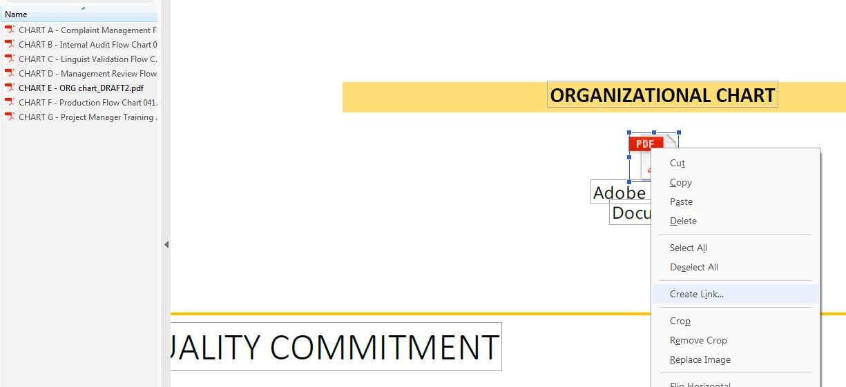

3. Then, according to instructions received, I should go to View-Tools_Content. What? There is no such option from the attach file window. You already saw it in the above screenshot. I only have the option OPEN. My menu is in Romanian. Deschidere means OPEN.
So, I assumed that first I should add the files as attachments, then to go to View-Tools-Content. Guess what? Still no such option.

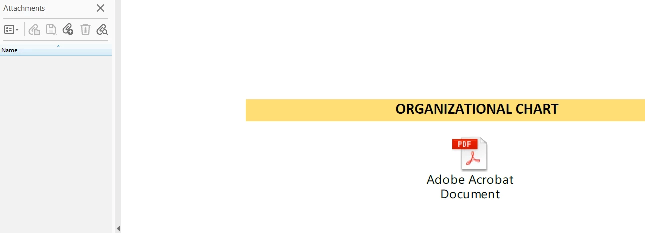

1. I clicked on Edit PDF, I selected the PDF icon and from Attachement tab, I dragged and dropped the PDF file I need it. As you probably already knew it did not work.
Useless to say that if I follow steps 5 and 6 will not work. As someone else already described when I double click on any PDF from Attachements tab it simply opens the file. Even a right click on that file will not display any option as SET LINK.

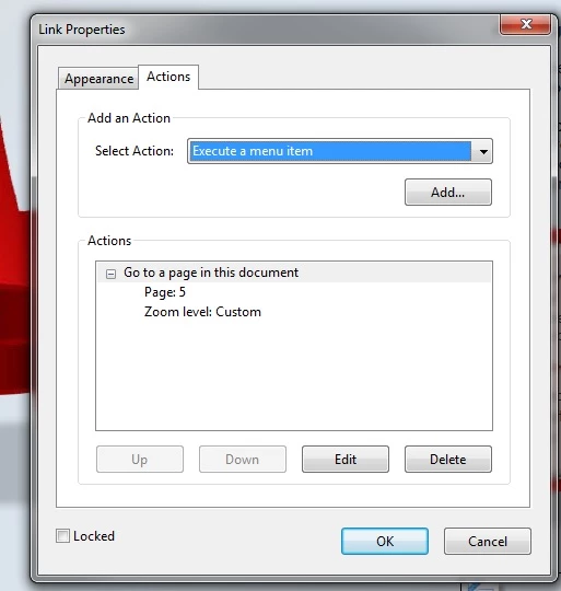

April 18, 2017
I am having trouble with step 6:
  • In the Attachments pane, double-click the attached file and click on Set Link.
When I double click the attached file in the attachments file, all it does it open the actual file. Then when I click 'set link', the link sets to the page view that I am currently on (i.e. it sets the link to open the current page, rather than the file). What am I doing wrong?
Bernd Alheit
April 18, 2017
How did you test the link?
April 20, 2017
I test the link by saving and closing the PDF and then reopening it in Adobe Reader.
In the properties for the link it looks like this:
I guess my problem that in step 6 "In the Attachments pane, double-click the attached file and click on Set Link." - double clicking on the link just opens the attachment and doesn't seem to connect to the link I am trying to set. I don't understand how double-clicking on the attachment in the attachment pane can do anything other than just open the link.

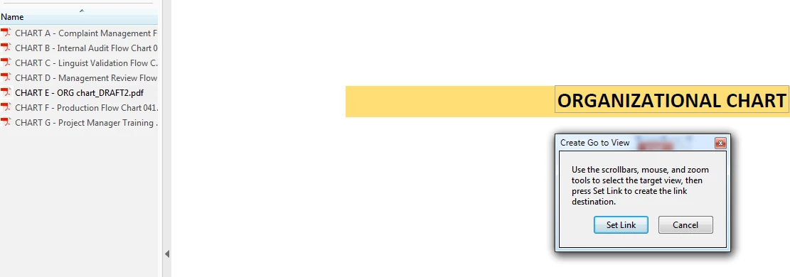

Correct answer
December 27, 2012
Have you tried using attachments?
  1. View – Show/Hide – Navigation Panes – Attachments
  2. Click the Add a new attachment icon.
  3. View – Tools – Content and select the Link icon.
  4. Select the text/image to create the link.
  5. In the Create Link dialog box, select Go to a page view and click Next.
  6. In the Attachments pane, double-click the attached file and click on Set Link.
