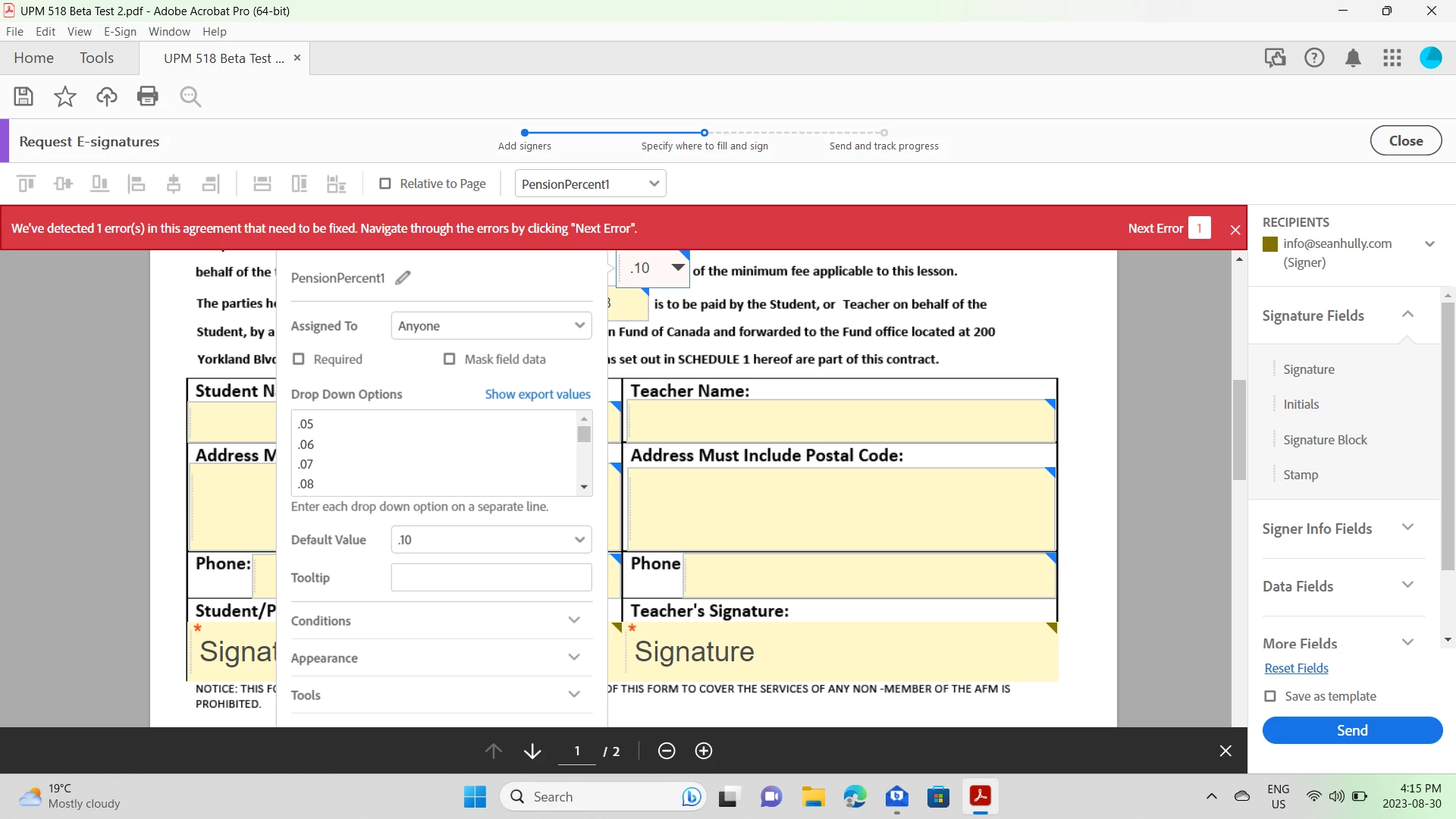

I'm trying to solve an error caused by a drop down list when I request e-signatures. It is a list of percentages for the user to choose for a pension contribution (between 5% and 18%). I don't know what's wrong because Acrobat doesn't highlight the error in red, unlike the other errors I fixed earlier. I've been working around it by not using drop downs, but I need a drop down in this case.
The form works great for the calclulations, but I can't send for signatures. Screen shot attached.

I solved it myself by not using the percentage format for the number. The user types in a whole number and I have a % sign beside it as text so it appears as 9%. I then do the calculation in a hidden field to get the percentage I need (9÷100) and go from there. It appears the form does not like the percentage format.

The screenshot shared above doesn't give much information about the error or the type of PDF form you are working with.
Also, as mentioned, the other errors in the form have been fixed, but this isn't highlighted. Is it possible for you to share the form with us for testing?
What if you remove the dropdown? Does it work as expected?
