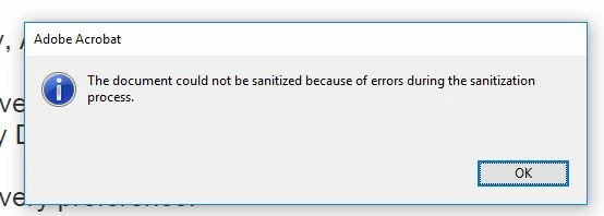

Hi, I've got a user who is getting the following error message when trying to redact, "The document could not be sanitized because of errors during the sanitization process".
Does anyone know how to resolve this issue?

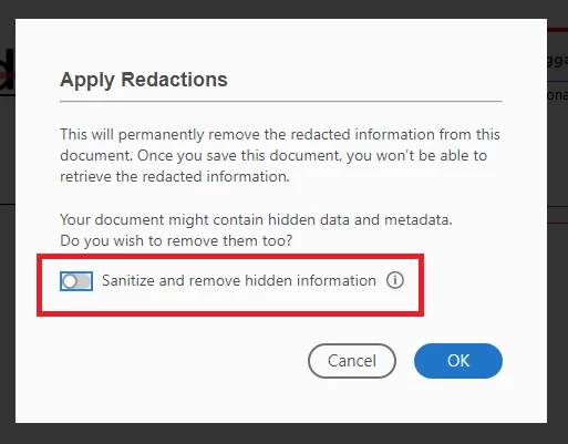

4. Can you try with sanitization option off in Apply dialog (snapshot below), this should temporarily solve this issue, but your document will not be sanitized. 
