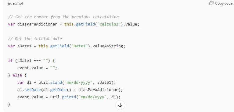

You can pull the number from the previous calculation field instead of hardcoding it. For example, if the previous calculation is in a field named calculo2, replace 35 with its value:867329i5BF15EE4C733FE51.png
✅ Make sure calculo2 is calculated before this script runs, otherwise it will return 0 or NaN.
