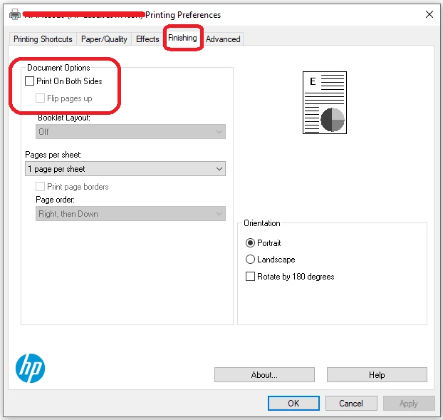

Feb 18, 2025 5:14 AM UTC
Change the printing preferences as below picture.

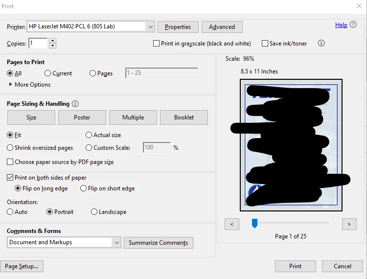

Can you provide a screenshot of your Print dialog in Acrobat?  It may help troubleshoot the issue.
Dave
_._._eAuthor
Mar 23, 2022 2:46 PM UTC
See below. LMK if you want to see properties/set up/advanced. Thanks
