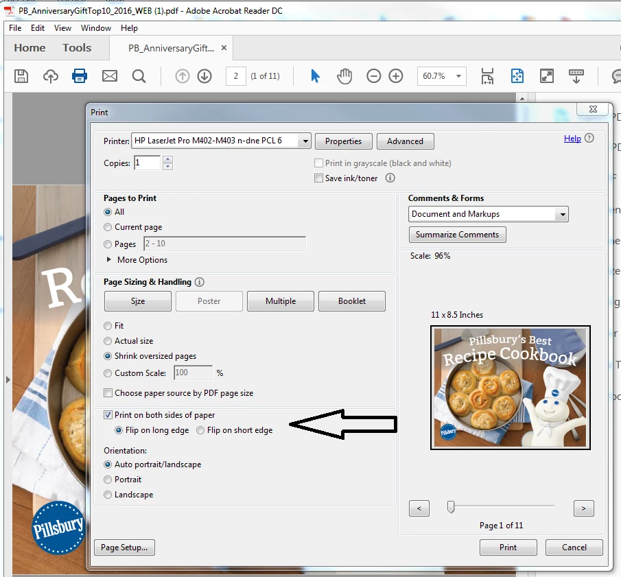

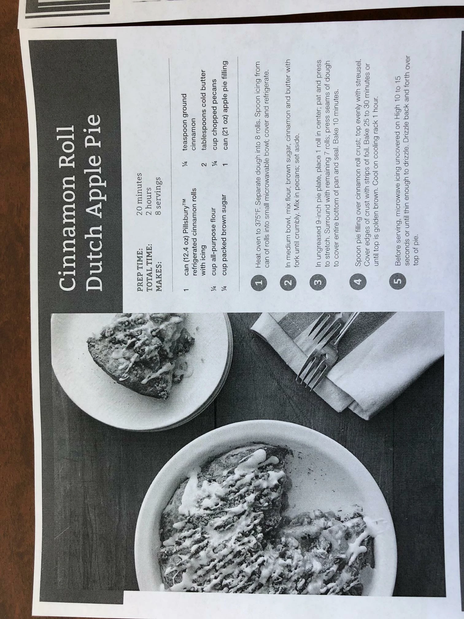

Every other page prints garbled images with lines vertically on the image
Every time I print multiple pages with HP M402n the pages (every other) are printed with garbled text and images.
Almost like its printing backwards.
patrickd9581306Correct answer
March 1, 2018
I went to Finishing tab in printer properties. I disabled the print on both sides.

Bless your heart!!! I've been experiencing this same issue, not everytime, but a lot. So far, so good. Thanks for the tip. I've tried several times to look for a solution. Stumbled across your solution this moring.
March 1, 2018
Is there a way to disable the setting "Print on both sides of paper" ? That seems to be why every other page is printing backwards and inverted.
I uncheck it but the next time I go into the print job it has it checked.
patrickd9581306AuthorCorrect answer
March 1, 2018
March 2, 2018
This fixed it

Hi Patrick,
Please answer a few questions to put us in the right mood:
What is your OS and version? What is your Acrobat version?
Please post also pictures of the printed pages.
Does this happen only with specific PDF files or also with standard PDF files (eg. PDF files that you grappled from the Adobe site and that are known to be good)?
As a workaround you could try to use "print as image" (Advanced tab of the print dialogue). Does that work?
March 1, 2018
Windows 7
Acrobat Reader DC, just ran update still happens
Any multipage pdf will do it.
I printed excel and that does multipages fine.
I printed Word and that seems ok too. Just PDF's are affected.
I installed  a HP M402n printer yesterday when this started
I have contacted them. They asked me to reach out to you.
March 1, 2018
Print as Image does not work
