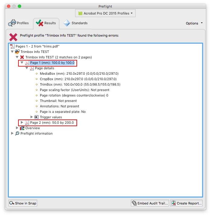

I guess it depends if this is more for internal use or external to a file supplier/client...

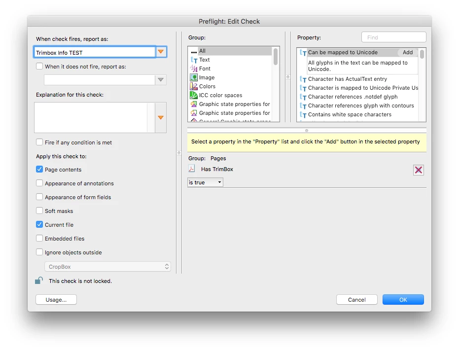

One option below using print production tools > preflight > single check using page box/trim box:
You can use the “create report button”...

I've followed the instructions and have managed to get the page sizes listed in preflight.  The results page contains really useful information.  It's probably my limited knowledge of Pitstop but I've not managed to get the sizes to print with the artwork.  When I run the report, text is added to the top left of the artwork which states 'All problems according to preflight profile' but no size information appears.  I suspect this is possible with Pitstop but I've not managed to work it out.  It would be really helpful if the page information could appear next to the artwork rather than on the artwork as the artwork varies considerably in size so will be difficult to read when printed on paper for checking.
