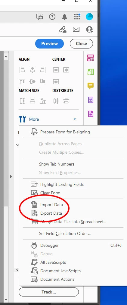

    3. Export an FDF file from it.  This can be done from the export menu item in the “prepare Form” tools (see image below), or for more control, use a script in the console window.
    4. In a simple text editor, open both the FDF created with your VB script and the one exported from the PDF in Acrobat. Compare the files. They won’t be exactly the same, but the path to the values and other required elements  should be the same in both.
