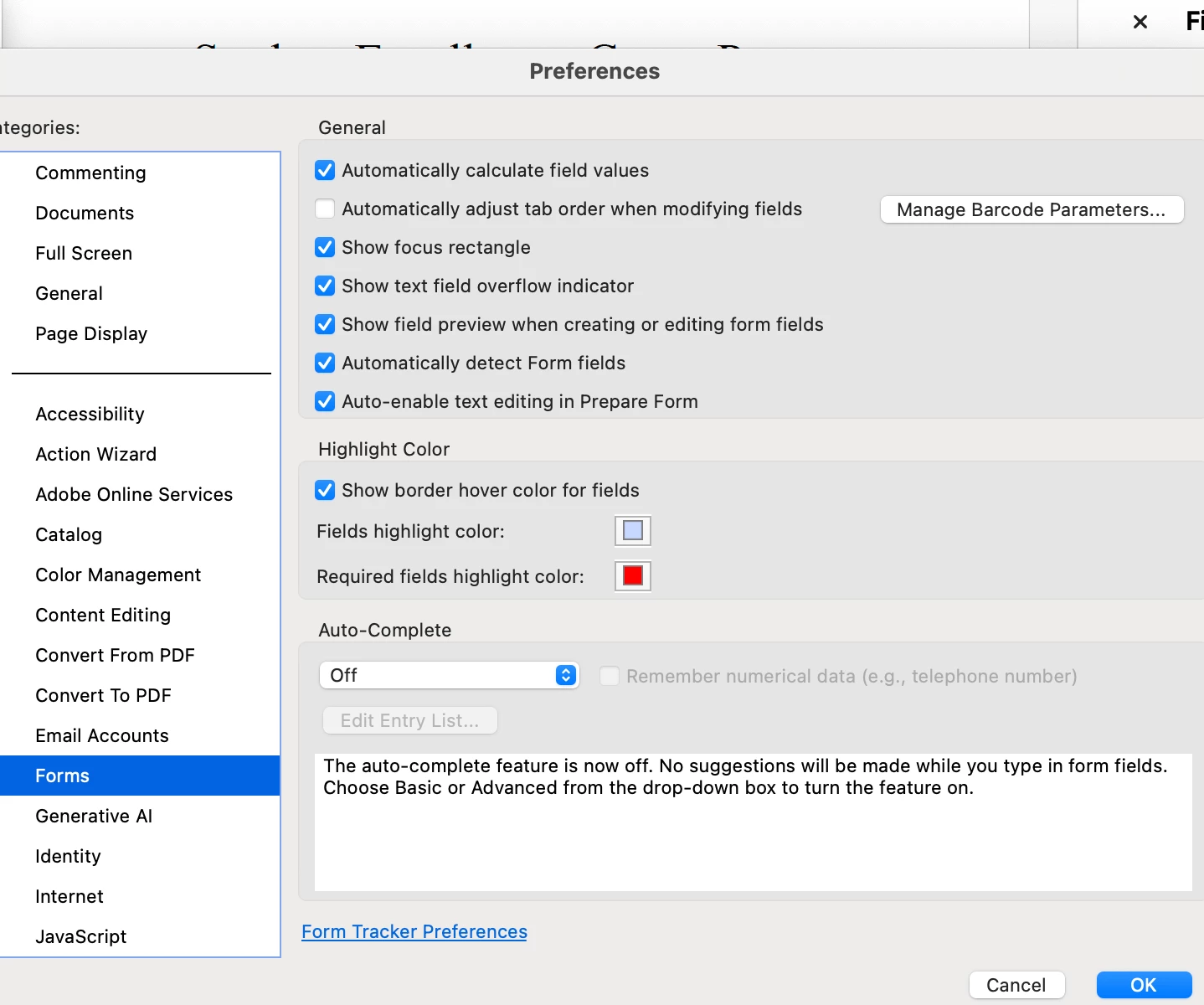

I'm pulling my hair out. I've done many of these forms and I've never had this problem.
I'm attaching screenshots.

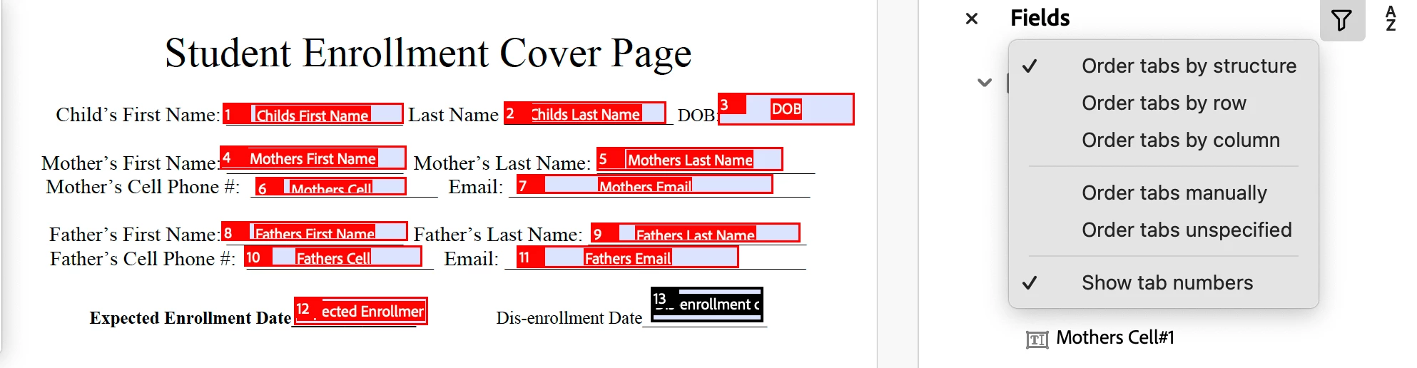

My fields are numbered and listed in the correct order. When I tab in "Prepare a Form" it tabs correctly. When I send the form to another email and complete it on my own, they tab incorrectly (though consistently).
I disabled "Automatically adjust tab order when modifying fields" as a troubleshooting step and nothing changed.
I've tried tabbing by structure and row. No changes.
I haven't tried manually sorting because they're already in the correct order.
How do I fix this? I've even deleted and recreated the DOB field and it still doesn't function correctly.

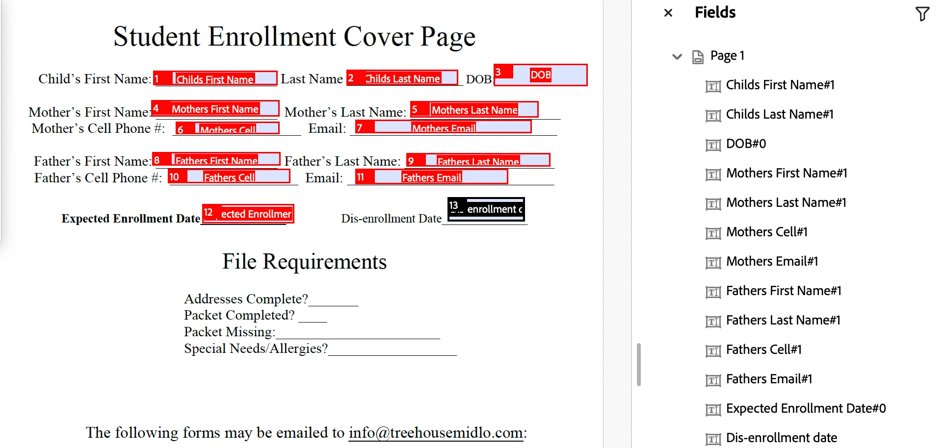

Here is the pdf. I think I fixed the DOB field finally. The others still aren't acting right.

I'm showing the DOB as field 13 both on-screen and in the fields list.
The other fields are in logical tab order and the PDF tabs as expected (with DOB being the last field).
