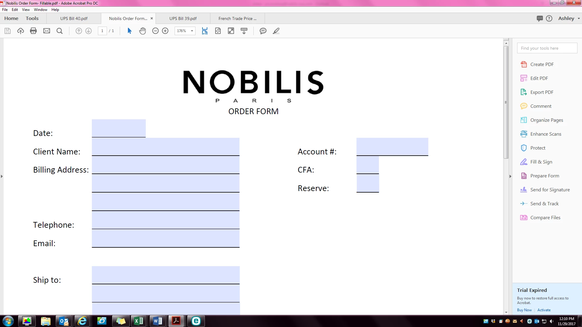

I created a fillable PDF with the Prepare Form and need it to print without the text box lines.  Is there any way to get rid of the lines when the form is ready to be printed?

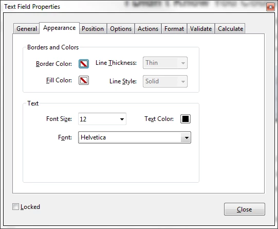

You mean the outline around the outside of the text field?
Change the appearance properties of the text field to not have a border, or border styling.

Hi Thom,
To create the fillable PDF we had to make a word doc. with _______ spaces to indicate where there would be a fillable field.  Once the person fills this out we want the PDF to print without that line ______ but we want to see the words filled in.
