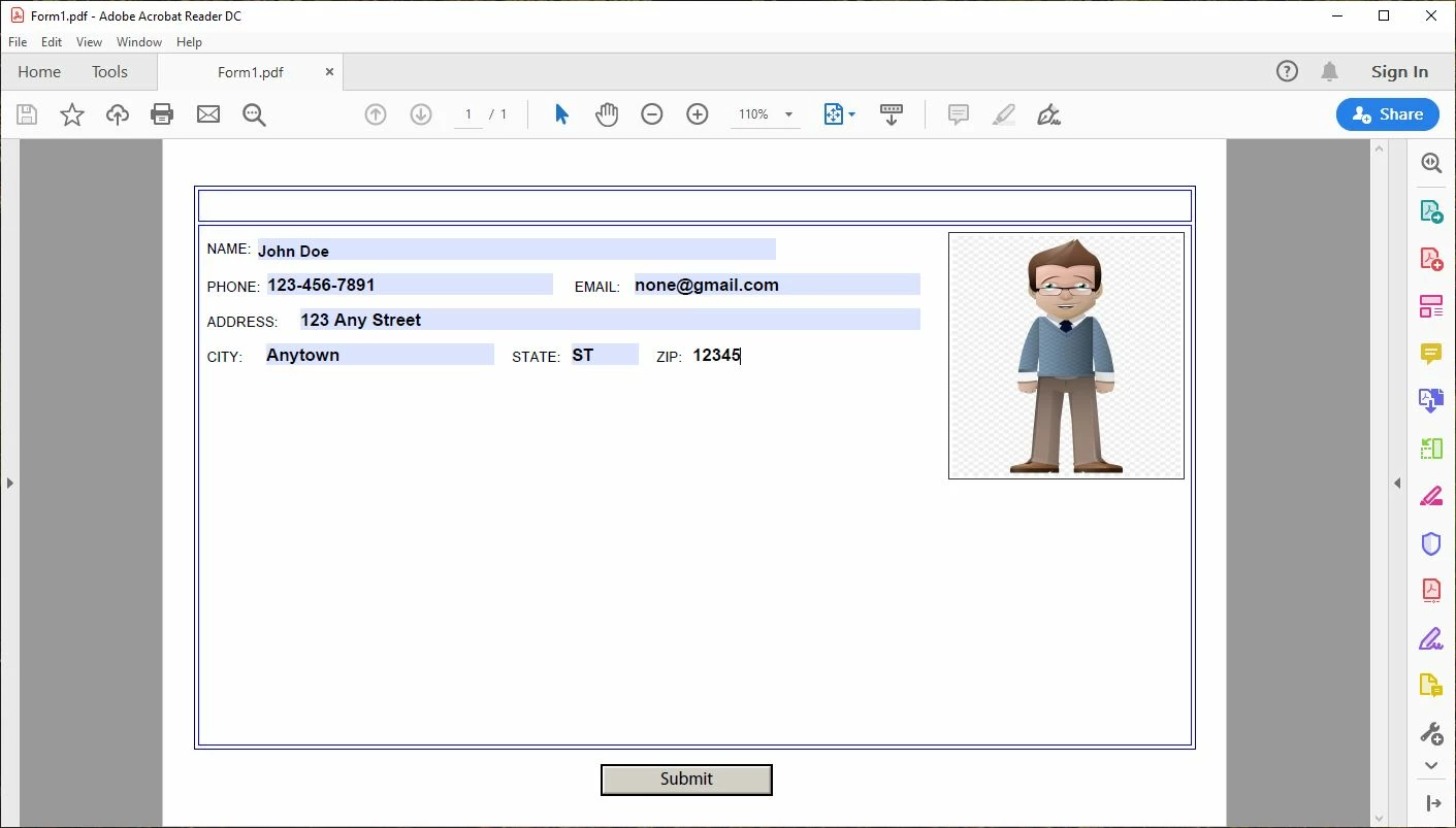

Created a fillable form
Created the Submit button that attaches the pdf and not just the xml

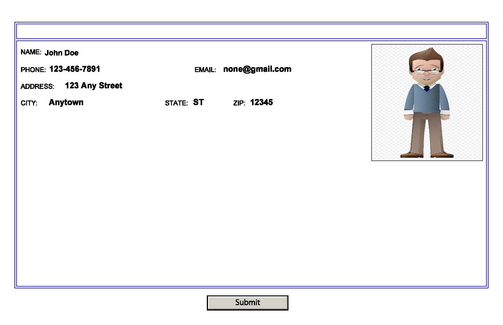

Question is I need the button to attach the "static" filled (not fillable form) form as if I had printed (say to a pdf printer driver) and attached to email.

Thanks for your reply Thorn,
I've been trying to figure this out for a while now.
Workflow:
I create fillable form (LiveCycle Designer, but want to know the idea works before investing in Acrobat DC)
Save form to server share with other forms of the like
End users open form in Reader and fill form
User presses submit button, email client opens new message and following pdf gets attached
Resulting pdf is emailed to a group of end users only to show them the un-editable information
Users: PC or Mac, not concerned about mobile platform.
Users need it that simple, or won't use it
I'm not a programmer, so fillable form needs to be built on the back end without miles and miles of coding
