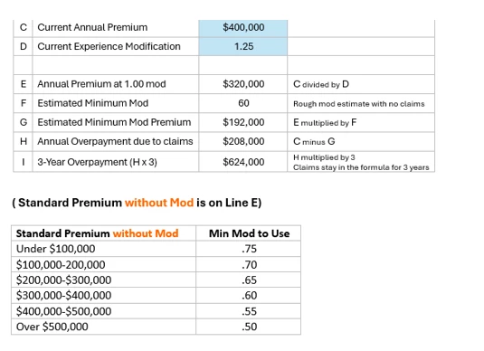

I have a table to calculate a result but cannot seem to get the java script right.  In Line F of the form, the Estimated Minimum Mod is calculated referencing the calculation in Line E. For example:  the table incorporates a range of numbers - if line E is $320,000, which is between $300,00-$400,00, then line F is .60 or if Line E is $90,000, which is less than $100,000 Then Line F is .75.  Line E is the result of Line C, the Current Annual Premium (which is entered by the user), divided by Line D Current Experience Modification (which is also entered by the user). The resulting number in Line F is used to calculate the number in Line G, which is E times F.   The calculations should flow, but I cannot get the script right for Line F to produce any number. I would greatly appreciate some help with the script for line F.  Thank you.

You can use this as custom calculation script of 'F' field:
var str = this.getField("E").valueAsString;
if(str == "")
 event.value = "";
else{
 var e = Number(str);
if (e < 100000)
 event.value = 0.75;
else if (e < 200000)
 event.value = 0.70;
else if (e < 300000)
 event.value = 0.65;
else if (e < 400000)
 event.value = 0.60;
else if (e < 500000)
 event.value = 0.55;
else
event.value = 0.50;}
Replace "E" with your actual field name in line E, and also pay attention to field calculation order.

Thank You - it worked perfectly.  On my end I had to fix labels, and upper/lower case on the lables.  Much gratitude to you!
