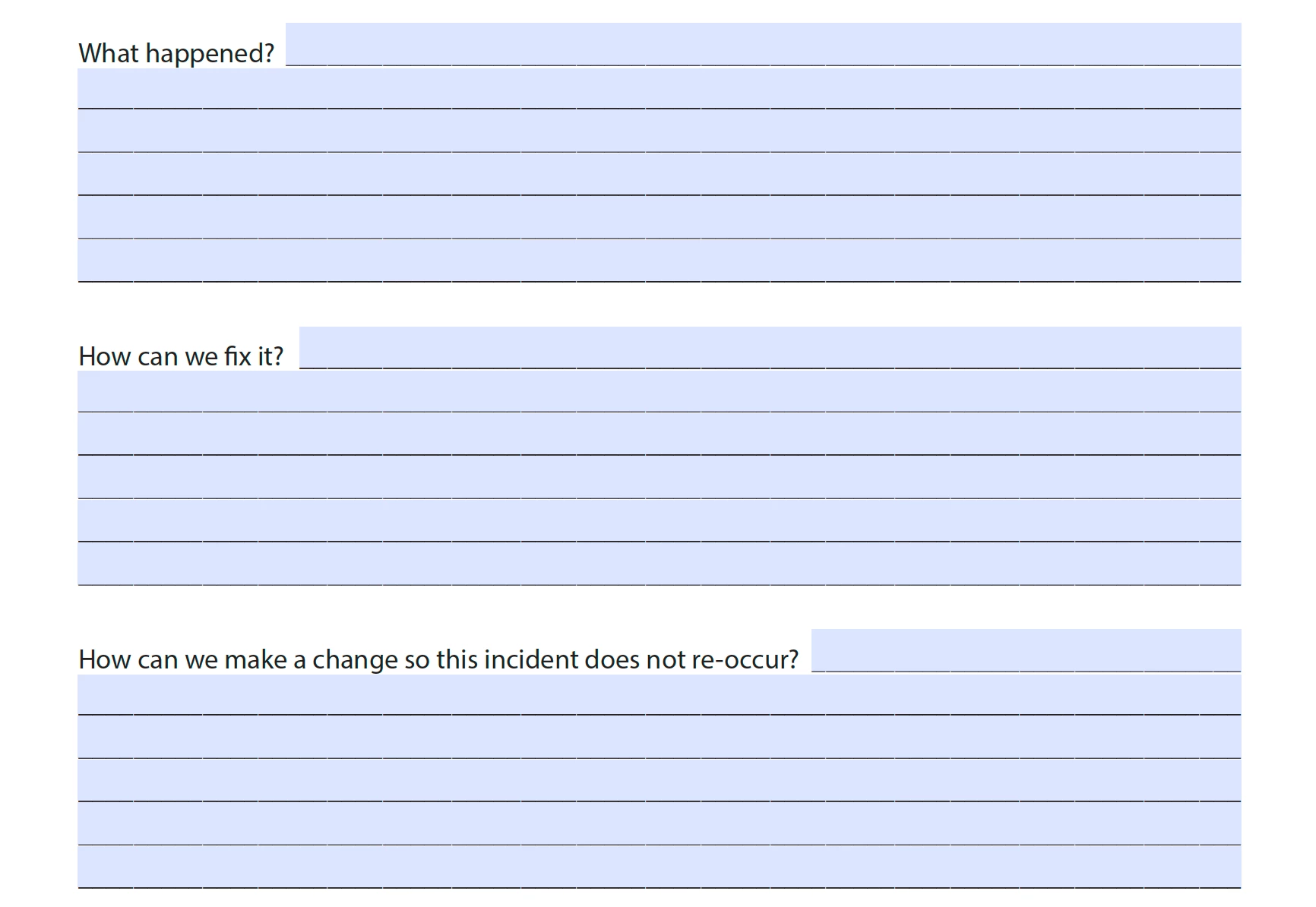

I am trying to get type to flow from one text box to another but every script I try isn't working. I'm not sure what I'm doing wrong. I have typed the script in and pasted the script. Is there anyone that has any knowledge of how I can make this work? Thank you for your help.

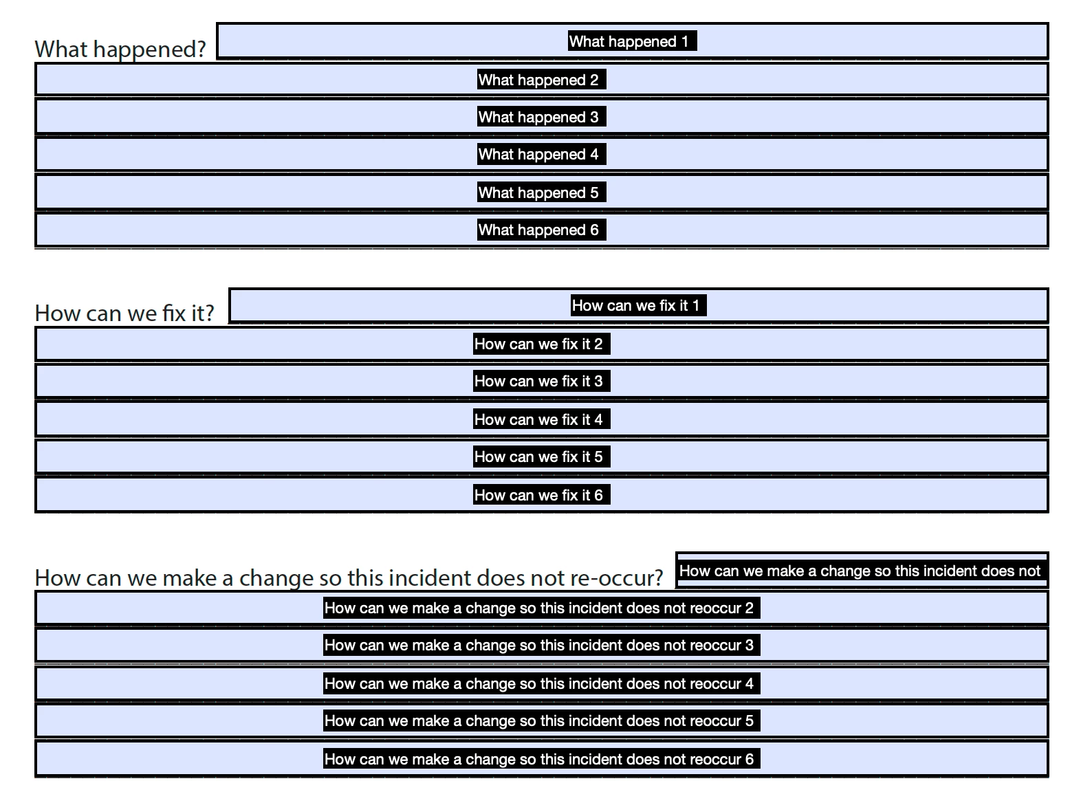

This is the script I have tried amongst others.
if (event.fieldFull || event.willCommit) this.getField("What happened 2").setFocus();
I have attached photos of my document as well for reference. I don't want to use one box with the multiline function as it is difficult to adjust the leading and I want the type to line up above the line.

However,  I think the most important observation is that I noticed that the texfield objects have very long name as sentence phrasing with spaces in between words.
That is not a good field object naming convention when using Acrobat JavaScript since it is known for sometimes throwing errors, specially if a field object is used for calculating events.
I would suggest to first try your original script  but changing the fieldnames to something short and preferably using a parent-child naming hierarchy, like for example:
"How.0", "How.1", "How.2", etc.
"What.0", "What.1", "What.2"
"Change.0", "Change.1", "Change.2",
