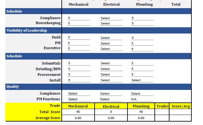

Good afternoon, I am new to this so giving this a try. I am creating a score card and need some assistance on adding some numbers and then diving the total by a set number ranging from 1 to 3. I have attached a photo of what I am referring to. I can add the numbers but having trouble with the division part of it. In summary, it needs to be total score divided by total number of trades (1-3) as noted for an average score. Any help would be much appreciated.
Thom Parker
February 19, 2020
Please start a new thread
