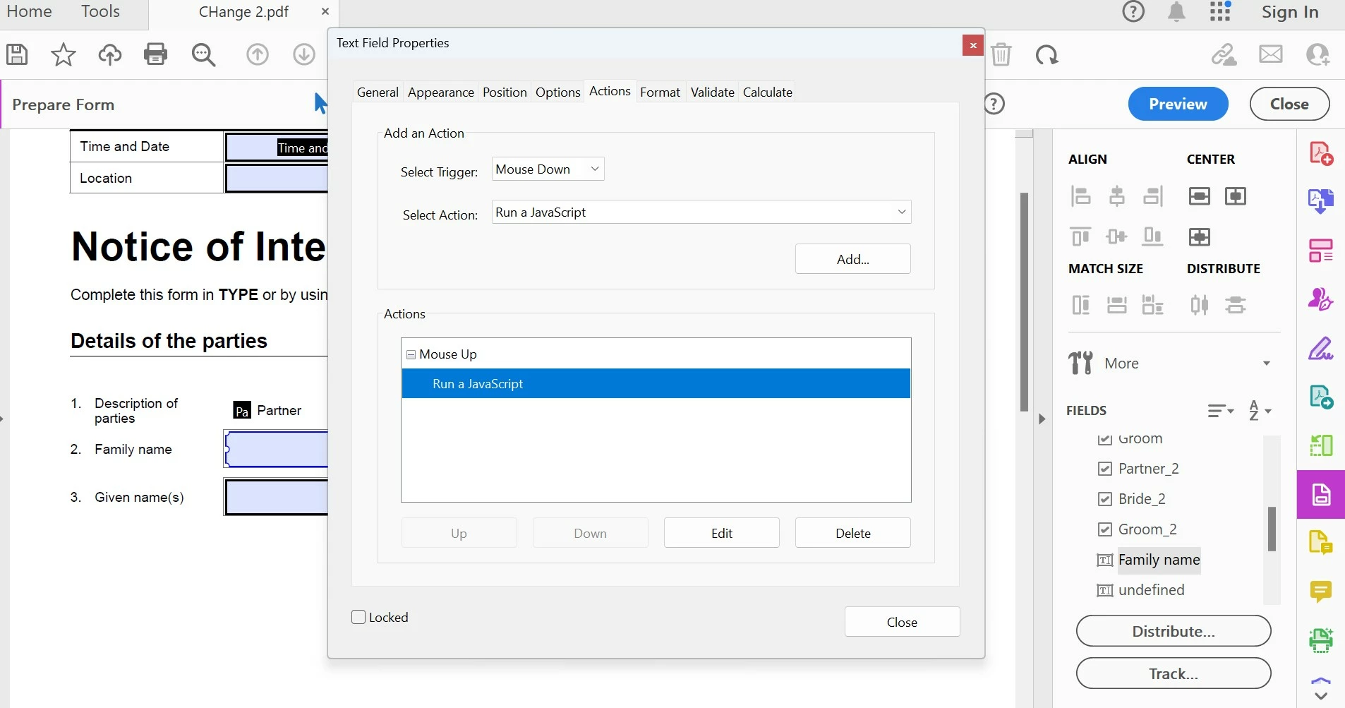

Thanks. It accepted the javascript now. But it seem not to respond to the instruction. It still does not respond to the javascript. Maybe i am entering it in the wrong place.
I selected the text field and clicked on the properties. Then i clicked on ACTION menu.
Question:
1. What trigger do i select in this instance. I have tried almost all the options in there.
2. What action do i select? I have tried RUN A JAVASCRIPT
Like i said before, i have successfully entered the script and it shows Run A Javascript like in the screenshot below. But even if i type my name MARK in the text field, it accepts it and saves instead of rejecting it as an error. I want the word HOME only to be accepted. It should reject all other words and pop up as INCORRECT ANSWER as in the script.
Bernd Alheit
June 6, 2024
Add the script at Validate.
