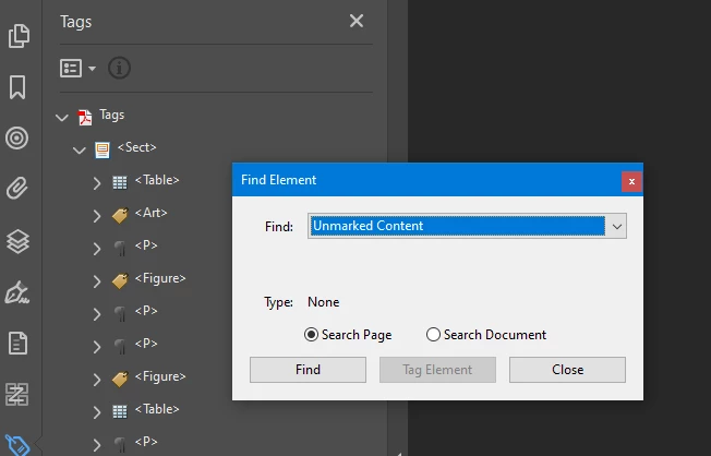

Dave__M
May 17, 2021
Have you visited the Find command in the Tags panel?  You may be able to search for unmarked content, and maybe that will uncover the hidden item.
My best,
Dave
May 18, 2021
Thank you but that didn't work.
