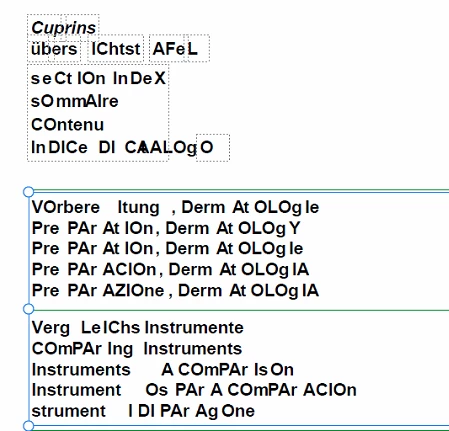

I am having the exact same issue described above. This has happened for a large multi-lingual document where I have added multiple text boxes translating existing text. How would I revert back to having prior existing text in all caps, as it was?
Re-exporting from source is not an option, because I'd then need to re-add my translations on hundreds of pages.
The fonts used are variants of Arial and Helvetica and show as "subset embedded" - so should be widely available.
Extra detail: for some reason, some of the text boxes are fragmented some are in one piece, but it also looks like the words have spaces inside them. See screenshot: you can notice fragmented and whole text boxes, with spaces inside the words.
This is on Acrobat 2025.001.20474 64bit (latest as of today) and Windows 11 (latest update as of today).
